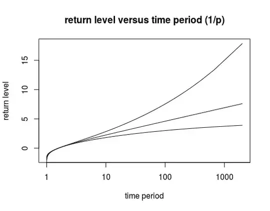

In the rest of the book, several return level plots are made by plotting the time period $T=1/p$ on the x-axis with a logarithmic scale. (like the graph on the bottom of this post)
But for this one graph, instead of plotting $\log(T) = \log(1/p) = - \log(p)$ the author chose to plot with $y_p = -\log(1-p)$.
It is not so clear why it was done because that type of return level plot does not return anywhere else in the book. Possibly it was done to show how to linearize the case of $\xi = 0$. This $y_p$ does occur a few times in the book and is explained as making it easier to evaluate the different models, because of the differences in linearity, concavity and convexity for respectively $\xi = 0$, $\xi > 0$ and $\xi < 0$.
Because the plot with $\log(y_p)$ is less typical, and because $y_p$ has no clear intuitive meaning (it is just a technical aid to linearized the graph), a little mistake with a minus sign might have slipped into to text.
The equation in the text, $z_p = \mu - \sigma \log y_p$, shows clearly that you get a line with negative slope. It may likely have been inverted to make the plot appear more like the other plots with $\log(T)$ on the x-axis.
mu   <- 0; sigma <- 1
p    <- ppoints(1000)
yp   <- -log(1-p)
zp_1 <- mu - (sigma/0.2)*(1-yp^(-0.2))   #xi =  0.2
zp_2 <- mu - sigma*log(yp)               #xi =   0
zp_3 <- mu - (sigma/-0.2)*(1-yp^(0.2))   #xi = -0.2
plot((1/p), zp_1, type = "l", log = "x", xlab = "time period", ylab = "return level", xaxt = "n") axis(1,at = 10^c(0:4)) lines((1/p), zp_2) lines((1/p), zp_3) title("return level versus time period (1/p)")
versus time period

  • (+1) Thank you very much for your answer. However I still have some questions: (1) To calculate the $z_i$ you still make use of $y_p = -\log(1-p)$, why would we not use $-\log(p)$ instead? and (2) What would the interpretation be of the $x$-axis on the original plot (the one that appears on the book)? – Bergson Sep 19 '21 at 21:39
  • @Bergson the $y_p$ doesn't really have a physical interpretation. The $y_p$ shows up as a variable that is useful in the analysis, but not because it has some special interpretation. (and because of this abstract meaning it is easy to mistakes with minus signs) – Sextus Empiricus Sep 19 '21 at 22:02
  • Why still make use of it? The reason to use it is because it linearizes the return level curve for the case $\xi = 0$. Compare for instance with the plot in my answer which is curved for time periods below 10. Visually it is difficult to see the difference between the curves in that part because they are all curved in the same way. – Sextus Empiricus Sep 19 '21 at 22:02
  • The problem that I have with the plot you presented is that it has negative return levels for some time periods $> 1$. This does not make much sense to me. However, if you instead do, for example: "plot(1/yp, zp_1, type = "l", log = "x")" you get a graph which is positive for return periods $> 1$ and also looks like the graph from the book (but with the $x$-axis resembling yours). Do you have any thoughts on this? – Bergson Sep 19 '21 at 23:45
  • I think it is an important issue, since return level approximations for smaller return periods are more precise, and thus it would be important to be accurate on the graph for smaller time periods. – Bergson Sep 19 '21 at 23:48
  • @Bergson the graph that I plotted is not like the one in the book. It wasn't supposed to be like that one. I plotted this graph with T=1/p instead of 1/yp because all the other graphs in the book are like that. – Sextus Empiricus Sep 19 '21 at 23:53
  • The negative return level also occurs in your plot and with the one in the book. When -log(yp) is around -2. Depending what those level are meant to be it should be possible to be negative. Of course you can not get negative rainfall, but for other types of variables it can be negative. For the GEV it has the range $-\infty < z < \infty$ – Sextus Empiricus Sep 19 '21 at 23:54
  • correction it depend on $\xi$. When $\xi = 0$ then the support of $z$ is from $-\infty$ to $\infty$ – Sextus Empiricus Sep 20 '21 at 00:00
    Thank you for your responses, the discussion has been insightful. I agree with you on the negative values aspect. However, looking at the source code for the R package created by the author, I still believe he plots $1/y_p$ (equivalently $-1/\log(p)$) on a logarithmic scale for the $x$-axis. This being said, even though we disagree on the final result, it was your response that lead me to an answer for my question, so I will award you the bounty and accept your answer. – Bergson Sep 20 '21 at 01:00
  • If he plots 1/y_p then the log corresponds to log(1/y_p) = -log(y_p). I am not sure what you mean by "I still believe...". It sounds like you are arguing, but I agree that he is doing that. – Sextus Empiricus Sep 20 '21 at 01:13
    Well, we are talking about two different plots here: (a) one with the $x$-axis being $(1/p)$ and (b) one with the $x$-axis being $1/y_p$, both on a logarithmic scale. Plot (b) yields a straight line when $\xi = 0$, whereas plot(a) does not; there are other minor differences between these graphs. You plotted (a) on your answer, whereas plot (b) looks more like the last graph on my question. Since the author used his own code for the book, I am saying I believe the rest of the plots in the book also correspond to the $x$-axis being $1/y_p$ on a logarithmic scale. – Bergson Sep 20 '21 at 01:25
    You are right about that package (which is a port by the way, and not the original from the author). The used variable is $-1/\log(f) = -1/\log(1-p) = 1/y_p$. It is wrong however that this axis is called the return period. It is only in the limit that $1/y_p \sim T$. – Sextus Empiricus Sep 20 '21 at 02:05
  • I agree with you. The axis should not be called that. Thank you very much for your time! – Bergson Sep 20 '21 at 02:41
