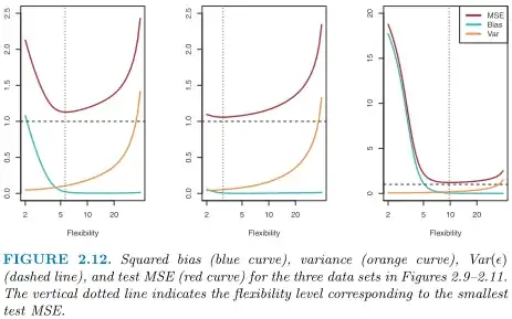

This looks like a very special case, as corresponding diagrams in machine learning textbooks are often asymmetric. See e.g. James et al. "Introduction to Statistical Learning" Figure 2.12:
I think the curious result of the initial picture rests on the curves of variance and squared bias being convex and rather symmetric. The convexity is probably sensible, but I am not so sure about the approximate symmetry.

Sorry to rain on your parade, but this does not necessarily hold. The picture is misleading. No, that is not an answer to your question, but I would assume this reduces our interest in it altogether...
As an example, assume model complexity $x$ can be parameterized in a single dimension with $0\leq x\leq 1$. Squared bias is given by $$ b(x) = 1-\sqrt{x}, $$ variance by $$v(x) = x^2, $$ and total error therefore by $$ e(x) = b(x)+v(x) = 1-\sqrt{x}+x^2. $$
bias and variance
Bias is decreasing, variance is increasing, both are convex, and the minimal error is achieved at $x=\frac{1}{4^\frac{2}{3}}$, far away from the point of intersection.
The result about minimal error appearing at the intersection should indeed hold if we posit symmetry of bias and variance. But then they would need to be symmetric about some specific $x$ value, and that particular $x$ value would then turn out to be the minimum error complexity. I would not think such a symmetry to be very common, or therefore interesting.
