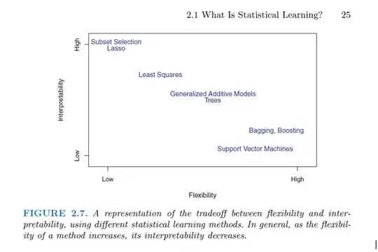

In my opinion the problem appears under the perspective of inference and interpretability used in this book. In fact this book also suggests that:
  • less flexible specifications are more far away from reality, then more biased, but at the same time they are more tractable and, then, more interpretable;
  • more flexible specifications are closer to the reality, hence less biased, but at the same time they are less tractable and, then, less interpretable.
As a result we have that linear regressions, OLS and even more LASSO, are the most interpretable and more powerful for inference. This graph tell this story:
This seems to me like a contradiction. How is possible that linear models are, at the same time, the more biased but the best for inference? And among linear models, how is possible that LASSO regression is better than OLS one for inference?

  • linear estimated model are indicated as the more interpretable even if the more biased.
  • linear estimated model are indicated as the more reliable for inference even if the more biased.
I read carefully the answer and comments of Tim. However it seems to me that some problems remain. So, actually it looks like in some sense the first condition can hold, i.e. in a sense where “interpretability” is a property of the estimated model itself (its relation with something "outside" are not considered).

There’s no contradiction. The fact that something is easy to interpret has nothing to do with how accurate is it. The most interpretable model you could imagine is to predict constant, independently of the data. In such case, you would always be able to explain why your model made the prediction it made, but the predictions would be horrible.
That said, it’s not the case that you need complicated, black-box models if you want accurate results and poorly performing models for interpretability. Here you can find nice, popular article by Cynthia Rudin and Joanna Radin, where they give example of interpretable models giving very good results and use it to discuss how performance vs interpretability is a false dichotomy. There’s also very interesting episode of Data Skeptic podcast on this subject hosting Cynthia Rudin.

  • Thanks for answer and links. Useful. However I’m worry about to not misunderstand what you, and the references you suggest, said. The doubts for me move around the words: interpretability, explanation, inference. You, and the suggested article of Rudin and Radin, never speak about “inference” but in my question I use it not by chance. You don’t use it by chance or because consider inference and interpretability not like synonyms? – markowitz Oct 26 '20 at 08:14
  • You can forget for a moment the figure 2.7 and can consider that Authors of book suggest that linear model are, at the same time, the more reliable for inference and the more biased. In other words you can put something like “reliability for inference” in the horizontal axis of the figure 2.7. If you don't trust me I can report some phrase about it. Now if we use the word “interpretability” in place of something like simplicity (no more), I agree with you. In this sense the constant model that you suggest, regardless his prediction performance, is easily interpretable but bad for inference. – markowitz Oct 26 '20 at 08:15
  • At the other side, if you affirm that constant model is useful for inference too, I disagree …. or at least we have to go deeper in the meaning of “inference”. – markowitz Oct 26 '20 at 08:16
  • Now, in the article of Rudin and Radin word like "explanation" is used many times. In my knowledge it is a synonym of causality. So, if in the horizontal axis of the figure 2.7 we put something like “reliability for causal inference” the problems become more and deeper and would be far from solved by your example and references you cited. – markowitz Oct 26 '20 at 08:16
    @markowitz "explainability" has nothing to do with causality. Explainability is about our ability to explain how did some algorithm made some prediction. This is complicated for something like deep learning, since there's a lot of moving parts and simple in case of linear regression, or decision tree. – Tim Oct 26 '20 at 08:20
  • As about "inference" vs "interpretability", your question and how you summarize what you've read since to treat those as synonyms. Inference means drawing conclusion from the data. With complicated, black-box models, they enable you to predict something, but you don't know why did they made the prediction they made. For simple models, you know why, so you can use this knowledge to learn that some things are related to each other (inferring correlation etc). – Tim Oct 26 '20 at 08:22
  • About: “"explainability" has nothing to do with causality. Explainability is about our ability to explain how did some algorithm made some prediction” It seems me a point of view. Some people intend “explanation” of the data/measure/functions as understand where data and results come from and what substantive meaning stand behind the always used concept of “relation”. – markowitz Oct 26 '20 at 09:23
  • For example in the article about the dispute between prediction and explanation, discussed here (https://stats.stackexchange.com/questions/342360/minimizing-bias-in-explanatory-modeling-why-galit-shmuelis-to-explain-or-to/486140#486140) the word explanation is indubitably used like synonym of causation. However we can stop here about this point, at most I can open another more focused question later. – markowitz Oct 26 '20 at 09:23
  • About "inference" vs "interpretability", if as you suggest, in multivariate context like our, the correct meaning of inference is about correlations/associations and no more … maybe problems come to solve. However remain the problem that simpler model, like linear, are indicated as more biased also. This fact seems me contradict the main principle of inference. I'm wrong? – markowitz Oct 26 '20 at 09:24
  • @markowitz as said in the answer, the fact that something can used for inference has nothing to do with how "good" it is. You are free to use both very good and very crappy models for inference. As also said, it is not true that the less interpretable models need to be less "good". Moreover, the fact that the model is biased, does not mean that it is "bad", there are cases where we prefer models that are more biased. – Tim Oct 26 '20 at 13:04
  • You said “Moreover, the fact that the model is biased, does not mean that it is "bad", there are cases where we prefer models that are more biased”. Yes, and the bias-variance tradeoff tell us why it is true. But this hold for prediction goal. – markowitz Oct 26 '20 at 17:45
  • In order to put away misunderstandings, let me clarify. My question move around potential ambiguities, therefore terminology matters a lot. “good” and “bad” depend for what. The potential contradiction that I invoke is, at first round, about “bias” vs “interpretability”. You, and Rudin and Radin paper, reply that biased model can be good for interpretation. I understand correctly? If so, the potential contradiction that I invoke can be rewrite as about “bias” vs “inference”. You, from comments, reply that biased model can be good for inference too. I understand correctly? – markowitz Oct 26 '20 at 17:45
  • @markowitz every model can be characterized by their bias and variance. "Inference" is not a feature of a model, but how the model is used. For some models it would be harder to use them for inference (learning something about the world) because we can hardly interpret how they come into the predictions, so this does not help us with understanding the data. Linear regression is a simple model, that gives simple, easy to understand (interpretable) explanations, for the same reason it is biased. – Tim Oct 26 '20 at 20:19
