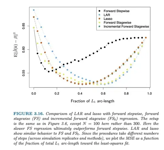

Here is the figure from the textbook:
It shows a decreasing relationship between subset size $k$ and mean squared error (MSE) of the true parameters, $\beta$ and the estimates $\hat{\beta}(k)$. Clearly, this shouldn't be the case - adding more variables to a linear model doesn't imply better estimates of the true parameters. What adding more variables does imply is a lower training error, i.e. lower residual sum of squares.
Is the $y$-axis labelled incorrectly? In particular, is it possible that the $y$ axis shows e.g. Residual Sum of Squares instead of $\mathbb{E}|| \hat{\beta}(k) - \beta||^2$?
EDIT:
Discussions and multiple attempts to reproduce revealed the axis is likely labelled correctly. In particular, it is not RSS since that will be on a completely different scale.
The title question still remains - "Is Figure 3.6 in ESL correct?". My intuition is that MSE should be lowest around the optimal $k$ (@SextusEmpiricus's answer suggests that's the case but there correlation is lower). Eyeballing Fig 3.6 we see MSE continues to go down beyond $k=10$.
In particular, I'm expecting to see curves similar to those in Figure 3.16: enter image description here
It does show additional procedures due to that is on a different $x$-axis; it also uses different number of samples (300 vs 100). What is relevant here is the shape of e.g. "Forward stepwise" (common in both charts - orange in the first, black in the second) which exhibits quite different behaviour across the two figures.
Final Edit

17
The plot shows the results of alternative subset selection methods. The image caption explains the experimental design: there are 10 elements of $\beta$ which are nonzero. The remaining 21 elements are zero. The ideal subset selection method will correctly report which $\beta$ are nonzero and which $\beta$ are zero; in other words, no features are incorrectly included, and no features are incorrectly excluded.
Omitted variable bias occurs when one or more features in the data generating process is omitted. Biased parameter estimates have expected values which do not equal their true values (this is the definition of bias), so the choice to plot $\mathbb{E}\|\beta -\hat{\beta}(k) \|^2$ makes sense. (Note that the definition of bias does not exactly coincide with this experimental setting because $\beta$ is also random.) In other words, the plot shows you how incorrect estimates are for various $k$ for various subset selection methods. When $k$ is too small (in this case, when $k<10$) the parameter estimates are biased, which is why the graph shows large values of $\mathbb{E}\|\beta -\hat{\beta}(k) \|^2$for small $k$.
Fortunately, that's not what the plot shows. Instead, the plot shows that employing subset selection methods can produce correct or incorrect results depending on the choice of $k$.
However, this plot does show a special case when adding additional features does improve the parameter estimates. If one builds a model that exhibits omitted variable bias, then the model which includes those variables will achieve a lower estimation error of the parameters because omitted variable bias is not present.

Is the $y$-axis labelled incorrectly? In particular, is it possible that the $y$ axis shows Residual Sum of Squares instead of $\mathbb{E}\|\beta -\hat{\beta}(k) \|^2$?
I don't think so; the line of reasoning posited in the original post does not itself establish that the label is incorrect. Sextus' experiments find a similar pattern; it's not identical, but the shape of the curve is similar enough.
As an aside, I think that since this plot displays empirical results from an experiment, it would be clearer to write out the estimator used for the expectation, per Cagdas Ozgenc's suggestion.
The only definitive way to answer this question is to obtain the code used to generate the graph. The code is not publicly available or distributed by the authors.
Without access to the code used in the procedure, it's always possible that there was some mistake in labeling the graph, or in the scale/location of the data or coefficients; the fact that Sextus has had problems recreating the graph using the procedure described in the caption provides some circumstantial evidence that the caption might not be completely accurate. One might argue that these reproducibility problems support a hypothesis that the labels themselves or the graphed points may be incorrect. On the other hand, it's possible that the description is incorrect but the label itself is correct nonetheless.
A different edition of the book publishes a different image. But the existence of a different image does not imply that either one is correct.

  • I agree $\mathbb{E}||\beta - \hat{\beta}(k)||$ is in general meaningful thing to look at, but I disagree with your statement that it shows "how biased your estimates are for various $k$" -- it shows bias + variance. For large $k>10$, let's take $k=20$ as example, I'll end up selecting 20 variables and estimating some betas for them (which will be non-zero almost surely) which will increase MSE. So I still don't understand how MSE goes down (or even stays the same). – dr.ivanova Nov 15 '20 at 17:04
    It does shows bias. Note that the y-label is NOT MSE. It's the average difference between the estimated and the true parameters. Usually you don't know the true parameters, but here the data is simulated so the underlying ground truth is known. – Matthew Drury Nov 15 '20 at 17:35
    @dr.ivanova It's not showing MSE, it's showing $\mathbb{E}|\beta -\hat{\beta}(k) |^2$, as indicated by the label on the graph. If you have a question about how MSE changes with the number of features you include in a regression, you could search our site. If you're not able to find an answer there, you can ask a new question by clicking the Ask Question button. – Sycorax Nov 15 '20 at 18:10
    I would say this chart is very misleading for a student as it doesn't make it clear regarding with respect to what the expectation is taken. – Cagdas Ozgenc Nov 15 '20 at 21:22
    If $\mathbb{E}|\beta -\hat{\beta}(k) |^2$ isn't MSE then what is? Is also says in the caption "shown is the mean-squared error". – Sextus Empiricus Nov 15 '20 at 22:22
    @SextusEmpiricus $\mathbb{E}(y - \hat{y})^2$ – Sycorax Nov 15 '20 at 22:50
    @Sycorax but what about the MSE of the coefficient? If $\mathbb{E}|\beta -\hat{\beta}(k) |^2$ is bias of the coefficient then what is the MSE of the coefficient? – Sextus Empiricus Nov 15 '20 at 22:51
    What about it? I don't understand what your line of questioning is intended to establish. – Sycorax Nov 15 '20 at 23:04
    I don't see how the y-label $\mathbb{E}|\beta -\hat{\beta}(k) |^2$ is bias instead of MSE. Also, eventually, the bias should go to zero when $k=31$, but there will be still error in the estimates. – Sextus Empiricus Nov 15 '20 at 23:05
    Why can't $\mathbb{E}|\beta -\hat{\beta}(k) |^2$ be called both "bias" and "MSE"? What other expression would you use to measure bias? Note that in particular, I think it's confusing to use MSE to refer to $\mathbb{E}|\beta -\hat{\beta}(k) |^2$ because MSE is very strongly associated with $\mathbb{E}(y-\hat{y})^2$, especially in a question that also asks about residual sum of squares. In other words, MSE without further qualifications of what error you're measuring is not very clear. – Sycorax Nov 15 '20 at 23:09
This is not just estimating variables, but also variable selection. When you only subselect <10 variables, then you are inevitably gonna make an error.
  • That is why the error decreases when you are choosing a larger size for the subset. Because more coefficients, which are likely coefficients from the true model, are being estimated (instead of left equal to zero).
  • The decrease of the error goes a bit further than $k=10$ because of the high correlation between the variables.
    The strongest improvement happens before k=10. But with $k=10$ you are not there yet, and you are gonna select occasionally the wrong coefficients from the true model.
    In addition, the additional variables may have some regularizing effect.
  • Note that after some point, around $k=16$, the error goes up when adding more variables.

There are good answers here, so I'll try to keep this brief and just add a couple points.
  • The point of this figure is to show how close the estimated slopes are to their true values, not how well the model predicts $y$ out of sample, or to whether inferences are valid.
  • Don't think of this as adding more variables. In all cases, you started with a fixed set of variables determined a-priori. The question is whether you should drop some of those variables for building your final model. Dropping variables based on what you see in your data is generally a bad thing to do. If you retain all variables (assuming you have enough data, which in this case you do) your estimates will be unbiased. Put another way, the variables whose slopes are actually $0$ in the data generating process should have slope estimates that are close to $0$ in the fitted model. They should be approximately correct. When you drop variables, that's no longer necessarily true.
    This case is more complicated, because the variables are all correlated with each other. The correlations mean that the slopes will vary from their true values more widely than they would have if the variables were all mutually orthogonal. As a result, if you pick just the right variables you could reduce the variance somewhat while maintaining the property of unbiasedness. However...
  • That's because your intuition is that stepwise procedures will pick the right variables. Unfortunately, that isn't necessarily what's going to happen. It is very unlikely that you will pick exactly the right variables. And, if you don't pick only the right variables, you will continue to get sampling distributions with higher variance and biased estimates.
    Now, let's consider picking the best, say, 15 or 20 variables. What is the probability that we will have included the 10 that we wanted and only thrown away worthless variables that just added noise? It's much better. That's why the curve is lower there.

I try to give an intuitive answer without actually checking and trying to reproduce the code. No idea whether the graph is wrong, but I will explain how it corresponds to my intuition.
The question has: "I think It shows a decreasing relationship between subset size k and mean squared error (MSE) of the true parameters, β and the estimates β^(k). Clearly, this shouldn't be the case - adding more variables to a linear model doesn't imply better estimates of the true parameters. (...) My intuition is that MSE should be lowest around the optimal k (somewhere between 5-10 due to correlations)."
What I think is going on is this. This is about variable selection. MSE of estimated betas should be smallest if exactly the correct 10 variables are selected. It should be substantially larger if at least one of these variables is missed. Note that correlation makes this problem worse, because if one of the correct nonzero beta variables is missed, its contribution will be attributed to those that are already in the model because of correlation. This will make their estimators worse, on top of the fact that there is an error from the missing $\beta$ itself. It is not true that the effect of correlation is that we can do well with fewer variables than the 10 correct ones, regarding the MSE of the estimators. It may be true for prediction, as the information of a missing variable is compensated for by other correlated variables already in the model. But this is not what the graph is about. The very same effect that may be helpful for prediction will be detrimental for estimation, because the effect of the missing correct nonzero beta variables will be divided among those that are already in the model, affecting their estimation.
This means that the minimum should occur at 10 only if always or almost always exactly the 10 correct variables are selected. But this is very unlikely, because correlation actually makes it very hard to find the correct variables. Chances are that if the procedure selects 11, 12, even 15 variables, still it's not too unlikely that one true nonzero beta variable is missed. True zero beta variables on the other hand will probably have fairly low estimated coefficients anyway, so will not harm the estimator MSE as much as a missed correct nonzero beta variable does. This explains in my view that the estimator MSE goes up only from about $k=16$ or even $k=27$ or so for stagewise. This seems all fine by me. What it shows is how many variables in this setup need to be selected in order to find all true nonzeroes with large enough probability. 16 seems realistic to me, and it is also clear that stagewise has a hard time in this problem, as it will need many steps to bring initially overestimated parameters down.
