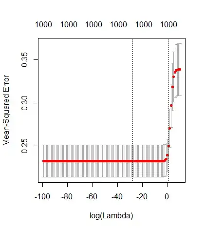

Update: There was some disbelief in the comments, so here is a reproducible example using glmnet. I use Python but R users will easily adapt the code.
%matplotlib notebook
import numpy as np
import pylab as plt
import seaborn as sns; sns.set()
import glmnet_python    # from https://web.stanford.edu/~hastie/glmnet_python/
from cvglmnet import cvglmnet; from cvglmnetPlot import cvglmnetPlot
# 80x1112 data table; first column is y, rest is X. All variables are standardized
mydata = np.loadtxt('../q328630.txt')   # file is here https://pastebin.com/raw/p1cCCYBR
y = mydata[:,:1]
X = mydata[:,1:]
# select p here (try 1000 and 100)
p = 1000
# randomly selecting p variables out of 1111
np.random.seed(42)
X = X[:, np.random.permutation(X.shape[1])[:p]]
fit = cvglmnet(x = X.copy(), y = y.copy(), alpha = 0, standardize = False, intr = False,
               lambdau=np.array([.0001, .001, .01, .1, 1, 10, 100, 1000, 10000, 100000]))
cvglmnetPlot(fit)
plt.gcf().set_size_inches(6,3)
plt.tight_layout()

  • Regarding possible bugs, I will post a cv.glmnet output tomorrow. – amoeba Feb 14 '18 at 23:37

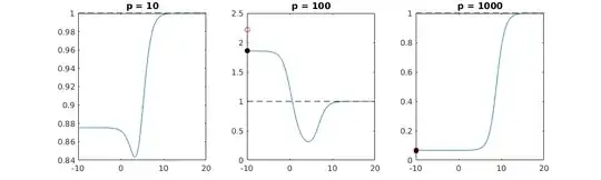

A natural regularization happens because of the presence of many small components in the theoretical PCA of $x$. These small components are implicitly used to fit the noise using small coefficients. When using minimum norm OLS, you fit the noise with many small independent components and this has a regularizing effect equivalent to Ridge regularization. This regularization is often too strong, and it is possible to compensate it using "anti-regularization" know as negative Ridge. In that case, you will see the minimum of the MSE curve appears for negative values of $\lambda$.
By theoretical PCA, I mean:
Let $x\sim N(0,\Sigma)$ a multivariate normal distribution. There is a linear isometry $f$ such as $u=f(x)\sim N(0,D)$ where $D$ is diagonal: the components of $u$ are independent. $D$ is simply obtained by diagonalizing $\Sigma$.
Now the model $y=\beta.x+\epsilon$ can be written $y=f(\beta).f(x)+\epsilon$ (a linear isometry preserves dot product). If you write $\gamma=f(\beta)$, the model can be written $y=\gamma.u+\epsilon$. Furthermore $\|\beta\|=\|\gamma\|$ hence fitting methods like Ridge or minimum norm OLS are perfectly isomorphic: the estimator of $y=\gamma.u+\epsilon$ is the image by $f$ of the estimator of $y=\beta.x+\epsilon$.
Theoretical PCA transforms non independent predictors into independent predictors. It is only loosely related to empirical PCA where you use the empirical covariance matrix (that differs a lot from the theoretical one with small sample size). Theoretical PCA is not practically computable but is only used here to interpret the model in an orthogonal predictor space.
Let's see what happens when we append many small variance independent predictors to a model:
Theorem
Ridge regularization with coefficient $\lambda$ is equivalent (when $p\rightarrow\infty$) to:
  • adding $p$ fake independent predictors (centred and identically distributed) each with variance $\frac{\lambda}{p}$
  • fitting the enriched model with minimum norm OLS estimator
  • keeping only the parameters for the true predictors
(sketch of) Proof
We are going to prove that the cost functions are asymptotically equal. Let's split the model into real and fake predictors: $y=\beta x+\beta'x'+\epsilon$. The cost function of Ridge (for the true predictors) can be written:
$$\mathrm{cost}_\lambda=\|\beta\|^2+\frac{1}{\lambda}\|y-X\beta\|^2$$
When using minimum norm OLS, the response is fitted perfectly: the error term is 0. The cost function is only about the norm of the parameters. It can be split into the true parameters and the fake ones:
$$\mathrm{cost}_{\lambda,p}=\|\beta\|^2+\inf\{\|\beta'\|^2 \mid X'\beta'=y-X\beta\}$$
In the right expression, the minimum norm solution is given by:
$$\beta'=X'^+(y-X\beta )$$
Now using SVD for $X'$:
$$X'=U\Sigma V$$
$$X'^{+}=V^\top\Sigma^{+} U^\top$$
We see that the norm of $\beta'$ essentially depends on the singular values of $X'^+$ that are the reciprocals of the singular values of $X'$. The normalized version of $X'$ is $\sqrt{p/\lambda} X'$. I've looked at literature and singular values of large random matrices are well known. For $p$ and $n$ large enough, minimum $s_\min$ and maximum $s_\max$ singular values are approximated by (see theorem 1.1):
$$s_\min(\sqrt{p/\lambda}X')\approx \sqrt p\left(1-\sqrt{n/p}\right)$$ $$s_\max(\sqrt{p/\lambda}X')\approx \sqrt p \left(1+\sqrt{n/p}\right)$$
Since, for large $p$, $\sqrt{n/p}$ tends towards 0, we can just say that all singular values are approximated by $\sqrt p$. Thus:
$$\|\beta'\|\approx\frac{1}{\sqrt\lambda}\|y-X\beta\|$$
Finally:
$$\mathrm{cost}_{\lambda,p}\approx\|\beta\|^2+\frac{1}{\lambda}\|y-X\beta\|^2=\mathrm{cost}_\lambda$$
Note: it does not matter if you keep the coefficients of the fake predictors in your model. The variance introduced by $\beta'x'$ is $\frac{\lambda}{p}\|\beta'\|^2\approx\frac{1}{p}\|y-X\beta\|^2\approx\frac{n}{p}MSE(\beta)$. Thus you increase your MSE by a factor $1+n/p$ only which tends towards 1 anyway. Somehow you don't need to treat the fake predictors differently than the real ones.
Now, back to @amoeba's data. After applying theoretical PCA to $x$ (assumed to be normal), $x$ is transformed by a linear isometry into a variable $u$ whose components are independent and sorted in decreasing variance order. The problem $y=\beta x+\epsilon$ is equivalent the transformed problem $y=\gamma u+\epsilon$.
Now imagine the variance of the components look like:
Consider many $p$ of the last components, call the sum of their variance $\lambda$. They each have a variance approximatively equal to $\lambda/p$ and are independent. They play the role of the fake predictors in the theorem.
This fact is clearer in @jonny's model: only the first component of theoretical PCA is correlated to $y$ (it is proportional $\overline{x}$) and has huge variance. All the other components (proportional to $x_i-\overline{x}$) have comparatively very small variance (write the covariance matrix and diagonalize it to see this) and play the role of fake predictors. I calculated that the regularization here corresponds (approx.) to prior $N(0,\frac{1}{p^2})$ on $\gamma_1$ while the true $\gamma_1^2=\frac{1}{p}$. This definitely over-shrinks. This is visible by the fact that the final MSE is much larger than the ideal MSE. The regularization effect is too strong.
It is sometimes possible to improve this natural regularization by Ridge. First you sometimes need $p$ in the theorem really big (1000, 10000...) to seriously rival Ridge and the finiteness of $p$ is like an imprecision. But it also shows that Ridge is an additional regularization over a naturally existing implicit regularization and can thus have only a very small effect. Sometimes this natural regularization is already too strong and Ridge may not even be an improvement. More than this, it is better to use anti-regularization: Ridge with negative coefficient. This shows MSE for @jonny's model ($p=1000$), using $\lambda\in\mathbb{R}$:

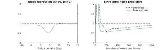

  • Also, see my last comment under Jonny's answer. I am wondering if adding pure noise predictors to the dataset can serve as a regularization strategy similar to ridge regression. This would be SO WEIRD if true. – amoeba Feb 17 '18 at 22:07
  • I am only taking about Ridge sure. Beware I assume all predictors are independent which means there is A LOT of noisy information. This is not the same at all as in Johny's example and probably not yours. Random predictors can't have the effect of regularizating. They lower the values of min-norm OLS $|\hat\beta|$ but don't improve the estimation. They degrade it. – Benoit Sanchez Feb 17 '18 at 22:20
  • Still don't understand last two sentences. If they relate to random X, then out-of-sample R-squared should be 0, while in-sample R-squared will be 1. – amoeba Feb 17 '18 at 22:29
  • Regarding random predictors, I am not so sure. If they lower the OLS beta, then it's exactly what shrinkage is supposed to do. – amoeba Feb 17 '18 at 22:30
  • Actually it does work. See an update to my answer. – amoeba Feb 17 '18 at 23:38
  • I did some experiments: $y$ depends on 40 first predictors and I add $p$ white noise predictors. As predicted, min-norm OLS and Ridge on all predictors perform roughly the same for large $p$. They sometimes reach some optimal $R^2$ for some $p$. It always tends towards 0 for large $p$ as predicted. The optimal $R^2$ is still far below Ridge on 40 first predictors. This is not like yours. Only difference: my 40 first predictors are independent. I'm still struggling to understand why this makes such a difference. – Benoit Sanchez Feb 18 '18 at 18:05
  • Sorry I don't fully understand your experiment from this description. Do you maybe want to update your answer with it? How exactly do you generate your y and X? When you say R^2, do you mean cross-validated R^2? – amoeba Feb 19 '18 at 09:07
  • Updated. I don't use CV since I'm not familiar with it (and I'm a bit paranoid about in this extreme scenario :-). I use theoretical MSE/R2 on a "random new observation". It is possible to compute it easily since the "true" beta is known. – Benoit Sanchez Feb 19 '18 at 11:44
  • Thanks, I will think about it when I have a moment. But when you compute your beta-ridge and beta-ridge-40, what lambda to you use? – amoeba Feb 19 '18 at 11:45
    Poorly hard-coded $\lambda$ proportional to $\sigma^2$. Sorry I didn't time for something proper. My main focus was the behaviour of min-norm OLS, to see that it differs from your example and that "some not too bad regularization" on 40 firsts was violently better. – Benoit Sanchez Feb 19 '18 at 11:50
  • I did some experiments. It seems some disagreement between our results is due to two aspects. First, you are using very low noise so that actually OLS solution is about as good as the optimal ridge on the 40 predictors. Try increasing the noise e.g. to $\sigma^2=0.5$. Second, you are computing $\beta-\hat\beta$ over all $p$ dimensions, whereas only 40 dimensions are of interest (the remaining dimensions were "added" for regularization purposes). I have it wrong in the code in my answer now (will fix), but the idea was to always reconstruct $y$ using only 40 predictors. – amoeba Feb 19 '18 at 16:10
  • I can kind of replicate your results (using my cross-validation code) if I use low noise and the whole $\hat\beta$ for reconstruction, but I get much better agreement between "fake predictors" and "ridge" once I increase the noise and use only "truncated" $\hat\beta$. Could you try if it works the same for you? – amoeba Feb 19 '18 at 16:12

Part I. Demonstration with artificial data and analytical CV
@Jonny (+1) came up with a really simple artificial example that I will slightly adapt here. $X$ of $n\times p$ size and $y$ are generated such that all variables are Gaussian with unit variance, and correlation between each predictor and the response is $\rho$. I will fix $\rho=.2$.
I will use leave-one-out CV because there is analytical expression for the squared error: it is known as PRESS, "predicted sum of squares". $$\text{PRESS} = \sum_i \left( \frac{e_i}{1-H_{ii}}\right)^2,$$ where $e_i$ are residuals $$e = y - \hat y = y - Hy,$$ and $H$ is the hat matrix $$H = X (X^\top X + \lambda I)^{-1} X^\top=U\frac{S^2}{S^2+\lambda} U^\top$$ in terms of SVD $X=USV^\top$. This allows to replicate @Jonny's results without using glmnet and without actually performing cross-validation (I am plotting the ratio of PRESS to the sum of squares of $y$):
This analytical approach allows to compute the limit at $\lambda\to 0$. Simply plugging in $\lambda=0$ into the PRESS formula does not work: when $n<p$ and $\lambda=0$, the residuals are all zero and hat matrix is the identity matrix with ones on the diagonal, meaning that the fractions in the PRESS equation are undefined. But if we compute the limit at $\lambda \to 0$, then it will correspond to the minimum-norm OLS solution with $\lambda=0$.
The trick is to do Taylor expansion of the hat matrix when $\lambda\to 0$: $$H=U\frac{1}{1+\lambda/S^2} U^\top\approx U(1-\lambda/S^2) U^\top = I - \lambda US^{-2}U^\top = I-\lambda G^{-1}.$$ Here I introduced Gram matrix $G=XX^\top = US^2U^\top$.
We are almost done: $$\text{PRESS} = \sum_i\Big( \frac{\lambda [G^{-1}y]_i}{\lambda G^{-1}_{ii}}\Big)^2 = \sum_i\Big( \frac{ [G^{-1}y]_i}{G^{-1}_{ii}}\Big)^2.$$ Lambda got canceled out, so here we have the limiting value. I plotted it with a big black dot on the figure above (on the panels where $p>n$), and it matches perfectly.
Update Feb 21. The above formula is exact, but we can gain some insight by doing further approximations. It looks like $G^{-1}$ has approximately equal values on the diagonal even if $S$ has very unequal values (probably because $U$ mixes up all the eigenvalues pretty well). So for each $i$ we have that $G^{-1}_{ii}\approx \langle S^{-2} \rangle$ where angular brackets denote averaging. Using this approximation, we can rewrite: $$\text{PRESS}\approx \Big\lVert \frac{S^{-2}}{\langle S^{-2} \rangle}U^\top y\Big\rVert^2.$$ This approximation is shown on the figure above with red open circles.
Whether this will be larger or smaller than $\lVert y \rVert^2 = \lVert U^\top y \rVert^2$ depends on the singular values $S$. In this simulation $y$ is correlated with the first PC of $X$ so $U_1^\top y$ is large and all other terms are small. (In my real data, $y$ is also well predicted by the leading PCs.) Now, in the $p\gg n$ case, if the columns of $X$ are sufficiently random, then all singular values will be rather close to each other (rows approximately orthogonal). The "main" term $U_1^\top y$ will be multiplied by a factor less than 1. The terms towards the end will get multiplied by factors larger than 1 but not much larger. Overall the norm decreases. In contrast, in the $p\gtrsim n$ case, there will be some very small singular values. After inversion they will become large factors that will increase the overall norm.
[This argument is very hand-wavy; I hope it can be made more precise.]
As a sanity check, if I swap the order of singular values by S = diag(flipud(diag(S))); then the predicted MSE is above $1$ everywhere on the 2nd and the 3rd panels.
figure('Position', [100 100 1000 300])
ps = [10, 100, 1000];
for pnum = 1:length(ps)
    rng(42)
    n = 80;
    p = ps(pnum);
    rho = .2;
    y = randn(n,1);
    X = repmat(y, [1 p])*rho + randn(n,p)*sqrt(1-rho^2);
    lambdas = exp(-10:.1:20);
    press = zeros(size(lambdas));
    [U,S,V] = svd(X, 'econ');
    % S = diag(flipud(diag(S)));   % sanity check
    for i = 1:length(lambdas)
        H = U * diag(diag(S).^2./(diag(S).^2 + lambdas(i))) * U';
        e = y - H*y;
        press(i) = sum((e ./ (1-diag(H))).^2);
    end
    subplot(1, length(ps), pnum)
    plot(log(lambdas), press/sum(y.^2))
    hold on
    title(['p = ' num2str(p)])
    plot(xlim, [1 1], 'k--')
    if p > n
        Ginv = U * diag(diag(S).^-2) * U';
        press0 = sum((Ginv*y ./ diag(Ginv)).^2);
        plot(log(lambdas(1)), press0/sum(y.^2), 'ko', 'MarkerFaceColor', [0,0,0]);
        press0approx = sum((diag(diag(S).^-2/mean(diag(S).^-2)) * U' * y).^2);
        plot(log(lambdas(1)), press0approx/sum(y.^2), 'ro');
    end
end
Part II. Adding pure noise predictors as a form of regularization
Good arguments were made by @Jonny, @Benoit, @Paul, @Dikran, and others that increasing the number of predictors will shrink the minimum-norm OLS solution. Indeed, once $p>n$, any new predictor can only decrease the norm of the minimum-norm solution. So adding predictors will push the norm down, somewhat similar to how ridge regression is penalizing the norm.
So can this be used as a regularization strategy? We start with $n=80$ and $p=40$ and then keep adding $q$ pure noise predictors as a regularization attempt. I will do LOOCV and compare it with LOOCV for the ridge (computed as above). Note that after obtaining $\hat\beta$ on the $p+q$ predictors, I am "truncating" it at $p$ because I am only interested in the original predictors.
IT WORKS!!!
In fact, one does not need to "truncate" the beta; even if I use the full beta and the full $p+q$ predictors, I can get good performance (dashed line on the right subplot). This I think mimics my actual data in the question: only few predictors are truly predicting $y$, most of them are pure noise, and they serve as a regularization. In this regime additional ridge regularization does not help at all.
rng(42)
n = 80;
p = 40;
rho = .2;
y = randn(n,1);
    e = y - H*y;
end
subplot(121)
hold on
xlabel('Ridge penalty (log)')
title('Ridge regression (n=80, p=40)')
ylim([0 2])
ps = [0 20 40 60 80 100 200 300 400 500 1000];
error = zeros(n, length(ps));
error_trunc = zeros(n, length(ps));
for fold = 1:n
    indtrain = setdiff(1:n, fold);
    for pi = 1:length(ps)
        XX = [X randn(n,ps(pi))];
        if size(XX,2) < size(XX,1)
            beta = XX(indtrain,:) \ y(indtrain,:);
        else
            beta = pinv(XX(indtrain,:)) * y(indtrain,:);
        end
        error(fold, pi) = y(fold) - XX(fold,:) * beta;
        error_trunc(fold, pi) = y(fold) - XX(fold,1:size(X,2)) * beta(1:size(X,2));
    end
end
subplot(122)
hold on
plot(ps, sum(error.^2)/sum(y.^2), 'k.--')
plot(ps, sum(error_trunc.^2)/sum(y.^2), '.-')
legend({'Entire beta', 'Truncated beta'}, 'AutoUpdate','off')
legend boxoff
xlabel('Number of extra predictors')
title('Extra pure noise predictors')
ylim([0 2])

Here is an artificial situation where this occurs. Suppose each predictor variable is a copy of the target variable with a large amount of gaussian noise applied. The best possible model is an average of all predictor variables.
library(glmnet)
set.seed(1846)
noise <- 10
N <- 80
num.vars <- 100
target <- runif(N,-1,1)
training.data <- matrix(nrow = N, ncol = num.vars)
for(i in 1:num.vars){
  training.data[,i] <- target + rnorm(N,0,noise)
plot(cv.glmnet(training.data, target, alpha = 0,
               lambda = exp(seq(-10, 10, by = 0.1))))
MSE for various lambda with 100 predictors
100 variables behave in a "normal" way: Some positive value of lambda minimizes out of sample error.
But increase num.vars in the above code to 1000, and here is the new MSE path. (I extended to log(Lambda) = -100 to convince myself.
MSE for various lambda with 1000 predictors
What I think is happening
When fitting a lot of parameters with low regularization, the coefficients are randomly distributed around their true value with high variance.
As the number of predictors becomes very large, the "average error" tends towards zero, and it becomes better to just let the coefficients fall where they may and sum everything up than to bias them toward 0.
I'm sure this situation of the true prediction being an average of all predictors isn't the only time this occurs, but I don't know how to begin pinpoint the biggest necessary condition here.
EDIT:
The "flat" behavior for very low lambda will always happen, since the solution is converging to the minimum-norm OLS solution. Similarly the curve will be flat for very high lambda as the solution converges to 0. There will be no minimum iff one of those two solution is optimal.
Why is the minimum-norm OLS solution so (comparably) good in this case? I think it is related to the following behavior that I found very counter-intuitive, but on reflection makes a lot of sense.

  • +1. That's a really nice artificial example!! I am not really convinced by your explanation (second paragraph from the last), but I hope that this simple toy example will provide controlled conditions to study this phenomenon and eventually lead to some insights. In my experience, a lot of things about regression and ridge regression can be better understood via SVD of X, so that's the direction in which I've been thinking (but haven't really figured it out yet). – amoeba Feb 15 '18 at 22:53
    (+1). The phenomenon thus seems to happens when predictors are correlated. It does not mean formally that the error curve has no minimum for positive $\lambda$, neither that the limit at 0 is not large. It just means that the curve tends to become flat, and that the threshold for how small $\lambda$ must be for regularization to stop working tends towards 0 for large $p$. Here this threshold goes beyond computational limit but Firebug's answer suggests it may always exist. – Benoit Sanchez Feb 16 '18 at 10:06
  • @BenoitSanchez I don't see any indication in this thread that there is a "threshold". One could use $\lambda=0$ (exactly zero), compute minimum-norm OLS solution, and use CV to estimate MSE. It would be instructive to supplement Jonny's answer with this direct computation, but I am very certain that there will be no difference with what cv.glmnet yields for 1e-10 or 1e-100. – amoeba Feb 16 '18 at 10:46
  • It was in Firebug's test with 1E-100 that he removed after your conversation. Yes minimum norm OLS is the way to know for sure. It can be done by projecting 0 orthogonally onto the space of solutions. Unrelated: I wonder how much CV estimates the true theoretical MSE. That can be known if true $\beta$ is known like in this example. – Benoit Sanchez Feb 16 '18 at 12:23
  • @BenoitSanchez There may be a computational limit, but it could also be that the minimum-norm OLS solution is for some reason optimal. I made an edit with a new graph, I wonder if you think it is more or less likely that it is a computational issue. – Jonny Lomond Feb 16 '18 at 12:48
    Why do you need glmnet in your update? If you only need minimum norm OLS solution then there is a direct formula (see the 2nd formula in my question) and if one computes SVD of $X=USV^\top$ then this formula becomes simply $\hat\beta=VS^{-1}U^\top y$. There is also probably a function in R that computes this solution but I don't really know R :) – amoeba Feb 16 '18 at 13:42
  • Thank you, I edited my code and graph to show the explicit solution. So it's not a computational issue. – Jonny Lomond Feb 16 '18 at 14:25
  • Cool. Very interesting discovery. I need to think about it. – amoeba Feb 16 '18 at 14:37
    Thinking about it some more it is not surprising at all. $y$ can be expressed exactly as a linear combination of vectors in $X$. $\hat{\beta}$ is the vector of coefficients with the smallest norm. When you add a vector the norm of $\hat{\beta}$ must decrease or stay the same size, because you could keep the old coefficients the same and set the new ones to zero. – Jonny Lomond Feb 16 '18 at 15:24
  • Makes sense. Meanwhile, I remembered that there is an explicit formula for ridge regression MSE with leave-one-out CV (https://stats.stackexchange.com/questions/32542) and managed to derive the limiting expression for $\lambda\to 0$. I will probably post it as a separate answer a bit later. – amoeba Feb 16 '18 at 16:01
  • An interesting direction would be to see whether the act of choosing the minimum norm OLS solution is "too much" regularization for this problem. You could look at the performance of solutions chosen from a distribution in "OLS solution space" centered on the minimum-norm solution with a CV-chosen variance or boundary. – Jonny Lomond Feb 16 '18 at 16:23
    Jonny's example is a good one because it has already been analyzed: see James-Stein estimator. When estimating the mean of a fixed vector $\mathbf{\theta}$ with dimension 3 or greater, we can always improve upon simple averaging by biasing towards zero, which is more or less what ridge regression does. I wonder if perhaps the improvement is too slight to be observed in this case? – Paul Feb 16 '18 at 18:48
    @Paul You are right: even for $p=1000$ the minimum is actually at some non-zero lambda (see my answer that I just posted). But it's almost indistinguishable from the minimum-norm OLS solution (asymptote to the left). We are trying to understand the conditions under which this is happening. The last part of Jonny's answer seems to suggest that it might happen always when $p\gg n$ which would be a rather extreme statement that I have NEVER seen in the literature. On the other hand, I don't think I've ever seen this issue discussed at all. – amoeba Feb 16 '18 at 22:27
  • No way it happens always, otherwise you could just duplicate columns of $X$ enough times to make an OLS that beats ridge. – Paul Feb 16 '18 at 22:41
  • @Paul but the statement would be that OLS beats ridge on the the set of duplicated columns, not that it would outperform ridge regression on the original set of predictors. That isn't absurd. – Jonny Lomond Feb 17 '18 at 00:07
    Whether or not it's absurd, I promise you it's not true. Go ahead and try to get OLS to beat ridge by duplicating columns of a fixed model matrix. You won't go from ridge winning to OLS winning by this method. – Paul Feb 17 '18 at 00:28
  • @Paul, the claim here is not that OLS "wins" or "beats" ridge; the claim is that OLS performs [almost] as good as ridge. That said, I agree with you that duplicating columns of X should not change the OLS performance. The coefficients will go down to zero though because they will "spread" across duplicates, but I don't think they will redistribute across the original X variables. I have not tested it though. – amoeba Feb 17 '18 at 08:30
  • I have tested it, Paul is right. However, if the added columns are not quite duplicate but instead correlated (I found good behaviour with correlation ~ 0.98), the behaviour arises. It does not seem to matter if there is any relationship between the target and the large number of correlated variables. – Jonny Lomond Feb 17 '18 at 13:06

Let's compare the regularization paths for both:
fit1000 = glmnet(x, y, alpha = 0, lambda = exp(seq(-10,10, length.out = 1001)))
fit100 = glmnet(x[, sample(1000, 100)], y, alpha = 0, lambda = exp(seq(-10,10, length.out = 1001)))
plot(fit1000, "lambda")
x11()
plot(fit100, "lambda")
It becomes clear $p=1000$ affords larger coefficients at increasing $\lambda$, even though it has smaller coefficients for asymptotically-OLS ridge, at the left of both plots. So, basically, $p=100$ overfits at the left of the graph, and that probably explains the difference in behavior between them.
It's harder for $p=1000$ to overfit because, even though Ridge shrinks coefficients to zero, they are never reach zero. This mean that the predictive power of the model is shared between many more components, making it easier to predict around the mean instead of being carried away by noise.
Firebug
  • 19,076
  • 77
  • 139
  • +1 Thanks for doing these experiments! It seems you are getting a tiny minimum for some non-zero lambda (I am looking at your figure), but the curve is still really really flat to the left of it. So my main question remains as to why $\lambda\to 0$ does not noticeably overfit. I don't see an answer here yet. Do you expect this to be a general phenomenon? I.e. for any data with $n\ll p$, lambda=0 will perform [almost] as good as optimal lambda? Or is it something special about these data? If you look above in the comments, you'll see that many people did not even believe me that it's possible. – amoeba Feb 15 '18 at 16:51
  • Also, I don't quite understand your last line. Look at the cv.glmnet output for p=100. It will have very different shape. So what affects this shape (asymptote on the left vs. no asymptote) when p=100 or p=1000? – amoeba Feb 15 '18 at 16:52
  • Do you know if mlr selects lambda.min or lambda.1se (in the cv.glmnet terminology)? – amoeba Feb 15 '18 at 18:34
  • @amoeba lambda.min. There's also a regr.cvglmnet learner, which probably allows one to select other rules. – Firebug Feb 15 '18 at 18:42
  • Thanks. To be honest I don't understand the output of your 1e-100 benchmark. E.g. for p=1100 it gives MSE=1.45. But here there is no hyperparameter tuning in the inner loop so basically one does not need inner CV loop at all. Meaning that the result should be the same as with non-nested CV at lambda=1e-100. But we see on the first figure that the MSE there is around 0.7. It does not make sense to me. – amoeba Feb 15 '18 at 20:05
  • @amoeba Hmm, I've ran the cv.glmnet with different lambda sequences and it does make a difference on the result (that's likely the reason for the 0.7 figure). Now, we know glmnet is based on the regularization path problem, so perhaps it's due to numerical rounding at such extreme regularization parameters. – Firebug Feb 15 '18 at 20:25
  • @amoeba about the inner CV, you're correct, that's the reason there's none for that model, it runs the outer CV only. – Firebug Feb 15 '18 at 20:26
  • @amoeba Alright, I added some more edits, TLDR: I think the regularization path makes some difference in model coefficients (code now reflect this). This is starting to creep outside my expertise, though, so perhaps you could pick up from here and add an improved, and perhaps definitive, answer? – Firebug Feb 15 '18 at 21:15
  • After the edits it mostly makes sense to me, but unfortunately I have to say that I still find the whole phenomenon as mysterious as before... In the end of the answer you show that lambda=0 with p=100 overfits (large erratic coefficients) but with p=1000 does not overfit (small coefficients that do not change over a large range of lambdas), but the question remains: WHY EXACTLY is this happening? As I said, the "common wisdom" is that p>n always yields bad overfitting... and this seems to be entirely wrong! – amoeba Feb 15 '18 at 22:09

Truncated beta technique in relation to ridge regression
I have transformed the python code from Amoeba into R and combined the two graphs together. For each minimal norm OLS estimate with added noise variables I match a ridge regression estimate with the same (approximately) $l_2$-norm for the $\beta$ vector.
  • It seems like the truncated noise model does much the same (only computes a bit slower, and maybe a bit more often less good).
  • However without the truncation the effect is much less strong.
  • This correspondence between adding parameters and ridge penalty is not necessarily the strongest mechanism behind the absence of over-fitting. This can be seen especially in the 1000p curve (in the image of the question) going to almost 0.3 while the other curves, with different p, don't reach this level, no matter what the ridge regression parameter is. The additional parameters, in that practical case, are not the same as a shift of the ridge parameter (and I guess that this is because the extra parameters will create a better, more complete, model).
  • The noise parameters reduce the norm on the one hand (just like ridge regression) but also introduce additional noise. Benoit Sanchez shows that in the limit, adding many many noise parameters with smaller deviation, it will become eventually the same as ridge regression (the growing number of noise parameters cancel each other out). But at the same time, it requires much more computations (if we increase the deviation of the noise, to allow to use less parameters and speed up computation, the difference becomes larger).
Rho = 0.2 comparing truncated noise with ridge regression
Rho = 0.4 comparing truncated noise with ridge regression
Rho = 0.2 increasing the variance of the noise parameters to 2 comparing truncated noise with ridge regression
code example
# prepare the data
set.seed(42)
n = 80
p = 40
rho = .2
y = rnorm(n,0,1)
X = matrix(rep(y,p), ncol = p)*rho + rnorm(n*p,0,1)*(1-rho^2)
# range of variables to add
ps = c(0, 5, 10, 15, 20, 40, 45, 50, 55, 60, 70, 80, 100, 125, 150, 175, 200, 300, 400, 500, 1000)
#ps = c(0, 5, 10, 15, 20, 40, 60, 80, 100, 150, 200, 300) #,500,1000)
# variables to store output (the sse)
error   = matrix(0,nrow=n, ncol=length(ps))
error_t = matrix(0,nrow=n, ncol=length(ps))
error_s = matrix(0,nrow=n, ncol=length(ps))
# adding a progression bar
pb <- txtProgressBar(min = 0, max = n, style = 3)
# training set by leaving out measurement 1, repeat n times
for (fold in 1:n) {
    indtrain = c(1:n)[-fold]
    # ridge regression
    beta_s <- glmnet(X[indtrain,],y[indtrain],alpha=0,lambda = 10^c(seq(-4,2,by=0.01)))$beta
    # calculate l2-norm to compare with adding variables
    l2_bs <- colSums(beta_s^2)
    for (pi in 1:length(ps)) {
        XX = cbind(X, matrix(rnorm(n*ps[pi],0,1), nrow=80))
        XXt = XX[indtrain,]
        if (p+ps[pi] < n) {
            beta = solve(t(XXt) %*% (XXt)) %*% t(XXt) %*% y[indtrain]
        else {
            beta = ginv(t(XXt) %*% (XXt)) %*% t(XXt) %*% y[indtrain]
        # pickout comparable ridge regression with the same l2 norm
        l2_b <- sum(beta[1:p]^2)
        beta_shrink <- beta_s[,which.min((l2_b-l2_bs)^2)]
        # compute errors
        error[fold, pi] = y[fold] - XX[fold,1:p] %*% beta[1:p]
        error_t[fold, pi] = y[fold] - XX[fold,] %*% beta[]
        error_s[fold, pi] = y[fold] - XX[fold,1:p] %*% beta_shrink[]
    setTxtProgressBar(pb, fold) # update progression bar
# plotting
plot(ps,colSums(error^2)/sum(y^2) ,
     ylim = c(0,2),
     xlab ="Number of extra predictors",
     ylab ="relative sum of squared error")
lines(ps,colSums(error^2)/sum(y^2))
points(ps,colSums(error_t^2)/sum(y^2),col=2)
lines(ps,colSums(error_t^2)/sum(y^2),col=2)
points(ps,colSums(error_s^2)/sum(y^2),col=4)
lines(ps,colSums(error_s^2)/sum(y^2),col=4)
legend(200,2,c("complete model with p + extra predictors",
               "truncated model with p + extra predictors",
               "ridge regression with similar l2-norm",
               "idealized model uniform beta with 1/p/rho"),
       pch=c(1,1,1,NA), col=c(2,1,4,1),lt=c(1,1,1,2))
# idealized model (if we put all beta to 1/rho/p we should theoretically have a reasonable good model)
error_op <- rep(0,n)
for (fold in 1:n) {
  beta = rep(1/rho/p,p)
    error_op[fold] = y[fold] - X[fold,] %*% beta
id <- sum(error_op^2)/sum(y^2)
lines(range(ps),rep(id,2),lty=2)
