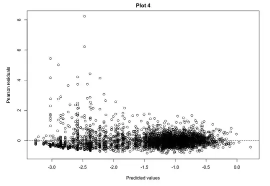

However, as you can see in plot 3, I get obvious residuals patterns with this model (note: predicted values have negative values because I scaled my predictors).
Then, as suggested in this other post, I included "natural splines" in my generalized linear mixed-effects model.
m1 <- glmer(a~ 1 + (b|ID),data = df, family=Gamma(link=log))
m2 <- glmer(a~ ns(b,4) + (b|ID),data = df, family=Gamma(link=log))
m3 <- glmer(a~ ns(b,4) + n.b +  (b|ID),data = df, family=Gamma(link=log))
m4 <- glmer(a~ ns(b,4) + n.b +  b:n.b + (b|ID),data = df, family=Gamma(link=log))
As you can see (Plot 4), the residuals improve a lot for m4. However, I don't remove patterns in residuals completely, since, at low activity values, there are higher residuals for a small proportion of data. I tried tens of settings for my model (changing the random effects, etc).
My question is, would it be justified if I validate m4 as a good model here independently of the residuals plot? The point is that the residuals' variance is higher at low heights according to method B (X axis), but if you look at Plot 1 you see that all the "outliers" are when the number of records are low, which means that there the estimation of the height was bad in these specific situations, and which is related to my animal's behaviour. Here, what I want is to calculate the variance of a explained by b (=r2m), to understand how well works method B, and then compared that with the r2m of a model which does not use n.b, to also understand how much importance n.b has for having good predictions. Thus, I don't know if r2m and AIC might be little affected by these residual patterns or not.
