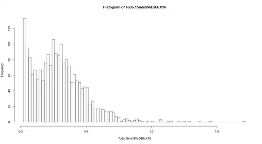

I want to model a response variable (y) as a function of two explanatory variables (x and z). y are concentration measures of a physiological parameter of the human body with a worldwide accepted method (method A). x is a novel method (method B) that might be alternative since it is much cheaper. However, it is thought that method B is more or less accurate depending on the time (z) that the equipment needed is used. So, my goal is to test the significance of x and z to accurately measure y. I have 6 individuals (ID: A,B,C,D,E,F). Below I show the relationship between x and y:
enter image description here *Note: here I categorized Z for illustration purposes, but z, as x, is numerical, ranging from 1 (hr) to 7 (hr).
Given that my response variable has a sharp non-normal distribution, that the variance increases as x increases, and that I have several individuals but I am not interested in differences among individuals, I though on GLMM with a GAMMA distribution to test the significant effect of x and z for explaining y.
I run GLMMs with a gamma distribution and using the log link.
