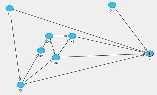

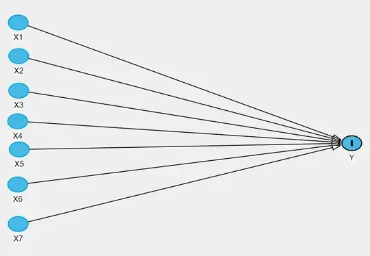

But first, what is the problem we want to overcome? This is what a multivariable regression model looks like to your statistical software:
The software does not “know” which variables are our main exposure, competing exposures, confounders or mediators. It treats them all the same. In the real world it is far more common for the variables to be inter-related. For example, knowledge of the particular area of research may indicate a structure such as:
It is the responsibility of the researchers to determine the causal pathways by utilising their expertise in the relevant subject matter. DAGs are graphical representations of a collection of causal ideas that are typically abstracted and relevant to certain causal relationships. It is not unusual for one researcher's DAG to differ from another researcher's DAG. Similarly, a researcher may develop several DAGs for the same study design. Employing DAGs in a systematic manner, as I will try to show below, serves as a means to acquire knowledge or substantiate a certain theory.
Let’s suppose that our primary interest is in the causal effect of $X7$ on $Y$. What are we to do? A very naive approach is simply to put all the variables into a regression model, and take the estimated coefficient for $X7$ as our “answer”. This would be a big mistake. It turns out that the only variable that should be adjusted for in this DAG is $X3$, because it is a confounder. But what if our interest was in the effect of $X3$, not $X7$ ? Do we simply use the same model (also containing $X7$) and just take the estimate of $X3$ as our “answer”? No! In this case, we do not adjust for $X7$ because it is a mediator. No adjustment is needed at all. In both cases, we may also adjust for $X1$ because this is a competing exposure and will improve the precision of our casual inferences in both models. In both models we should not adjust for $X2$, $X4$, $X5$ and $X6$ because all of them are mediators for the effect of $X7$ on $Y$.
