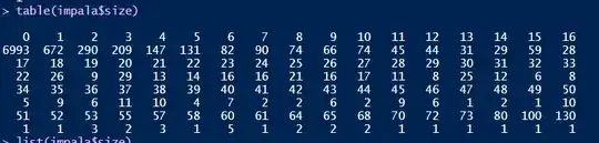

I am analysing a data set that is created from walking transects and recording counts for each group size of animals observed. Each transect has 41 repeats, which was approximately 80% zeros. However, within the actual observations, the counts also vary greatly with a large number of small group sizes but some >60 individuals as well.
I want to analyse these data to determine the type of habitat that is preferable to this species by modeling the count data against the environmental covariates that occur at each transect. I have begun with a logistic regression, for which I converted to a logistic vector for all surveys where 1=presence and 0="pseudo absence". The raw count frequencies are as in the screenshot (sorry I didn't know how else to export this without creating a mess of numbers)
I would now like to look at a finer scale of how the preference of habitat varies among the habitats indicated with a higher proportional "selection" from the logistic regression model. Thus I subsetted the data to just the observations (counts>0). Which have the following distribution (x-axis is group size)
