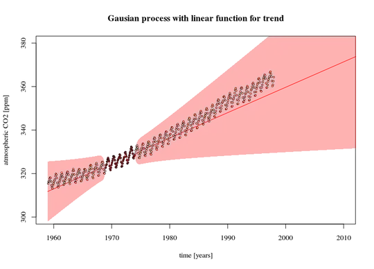

  2. since the mean function for time series forecasting with GPs is usually assumed to be zero, when I compute a forecast sufficiently far in the future, I expect it will revert to the mean of the data. This seems a particularly poor choice, because I would like to be able (in principle) to forecast as far in the future as I want, and the model manage to get the overall time trend right, with just an increase in the prediction uncertainty (see the case below with an ARIMA model):
how is this taken care of, when using GPs for time series forecasting?

  • @DeltaIV What do you mean by 'in time series data, the sample is not iid'? If it is because of correlation, then isn't this covered by the covariance function $k(t,t')$? – Sextus Empiricus Nov 26 '18 at 10:38
  • @MartijnWeterings well, the usual assumption in time series is that errors aren't independent, isn't it? For example, the signal in a financial time series can be approximated (very crudely) as some trend + brown noise. To get to iid errors, we use differencing in, e.g, ARIMA models. Anyway this is only part of the question. Even if you prove that the introduction of the covariance function plays the same role as differencing in nonseasonal models, there is still the problem of forecasting beyond the range of historical data (point 2). ARIMA models can forecast well beyond this range, 1/2 – DeltaIV Nov 26 '18 at 11:22
  • 2/2 reverting to the mean of the historical data. Also, and this is perhaps even more important!, the uncertainty of an ARIMA forecast will keep increasing, the further in the future you predict. Instead, the predictive uncertainty of a GP is bounded. – DeltaIV Nov 26 '18 at 11:24

  • @MartijnWeterings Re: 2; I'm not sure. Numerical experiments seem to indicate that this is not the case, i.e., the prediction interval is bounded for $\vert\vert\mathbf{x}^*\vert\vert\to\infty$ . However, since the expression of the posterior variance contains the inverse of a matrix whose norm is not necessarily bounded away from zero, it's not so easy to perform an asymptotic analysis of the width of the prediction interval for a GP. If you can do that, by all means feel free to submit an answer. – DeltaIV Nov 29 '18 at 09:21
  • @MartijnWeterings I stand corrected. The prediction interval doesn't increase indefinitely in width for $\vert\vert\mathbf{x}^\vert\vert\to\infty$, because the only matrix which is inverted doesn't depend on $\mathbf{x}^$. Here is the variance of the posterior predictive distribution: $k(\mathbf{x}^,\mathbf{x}^) +\sigma^2_n-\mathbf{k}(\mathbf{x}^, \mathbf{X})^T[K(\mathbf{X},\mathbf{X})+\sigma^2_nI]^{-1}\mathbf{k}(\mathbf{x}^, \mathbf{X})$. Since $k(\mathbf{x}^,\mathbf{x}^)$ is bounded for periodic kernels, it's pretty clear that the prediction interval is bounded. – DeltaIV Nov 29 '18 at 09:30
