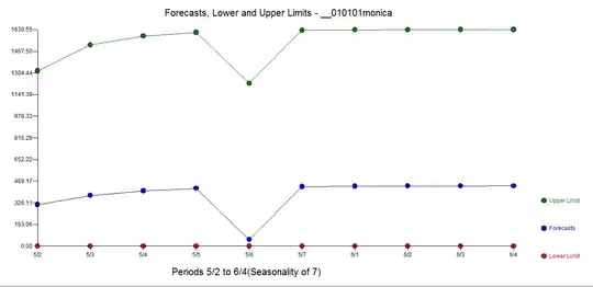

I took your 29 days (oldest to newest) and found that there were 3 unusual days thus the following equation enter image description here with Actual/Fit and Forecast here enter image description here
All models are wrong ... but some are useful .... . It is fundamentally an autoregressive process of order 1 after one has adjusted for the three "unusual data points " see enter image description here for a clear support for the anomaly identification.
Plot of the residuals enter image description herefrom the above model suggesting reduced variability is clearly obvious . It is reasonable to suggest that there has been a break-point in the model error variance suggesting GLS or a weighted model . This was not not investigated here due to sample size ! ).
Here is the plot of the original data enter image description here
While the variability of the series is higher at higher values suggesting to some that there is a need for logarithms http://stats.stackexchange.com/questions/18844/when-and-why-to-take-the-log-of-a-distribution-of-numbers ..it is truer yet that the error variance distribution is better characterized as having a deterministic change point at or about day 11.

ROUND TWO:
You asked “how do I do this with the log-link function and quasi(Poisson) errors?”. I say put aside your priors suggesting a particular fixed model and use a data-driven empirical process to identify the (possible) memory model, refining parameters and testing both necessity and sufficiency.
When you only have 29 days (4 seasons of daily data), I am normally reluctant to enable the automatic process to consider seasonal activity like day 6 as the OP has smartly viewed and pointed out ... a win for the human!
Following is the audit trail .... the ACF of the original series is here:
I suggested the possibility of a day 6 effect to the software which then identified supported that hypothesis while detecting three unusual points while incorporating an ar(1) effect shown here and here enter image description here and the companion PACF of the original series here:
The Actual/Fit and Forecast is here:
with forecasts here:
... all without assuming logarithms or any other possible unwarranted transformation.
Logs can be useful but the suggestion for a power transform for a theoretic model should never be made based upon the original data but on the residuals from a model which is where all the assumptions are placed that need to be tested. When (and why) should you take the log of a distribution (of numbers)?
Notice the ACF of the residuals series suggesting that it that the model can not be proven to be insufficient
and a supporting (not quite perfect !) residual plot here:
As Isaac Asimov said “the only education is self-education” and your question is certainly in that spirit.
EDITED AFTER OP REQUESTED A LONGER PERIOD OF FORECASTS (149 FORECAST PERIOD WAS USED )
Here is the Actual/Fit & Forecast graphenter image description here with forecasts here enter image description here
Simulation is perenter image description hereformed using the residuals from the model here
I selected not to allow for future anomalies and report here the simulation ( see Bootstrap prediction interval for an introductory discussion ) for a few select periods ahead
period 30 ... 1 day ahead
period 31 .... 2 day ahead
period 34 .... 5 day ahead (this is day 6 of the week )
period 178 ... 149 days ahead
And the sum for the next 149 periods Q.E.D. here
this example shows how prediction limits shouldn't be assumed to be symmetrical as errors form a useful model may not be normally distributed BUT are what they are.
Should you wish to extend the forecast period to 335 days to give you a 364 expectation simply prorate the 149 day prediction to 335 and add the actual for the first 29 (335 + 29 =364 ) to get your desideratum expectation for the first year.
Additionally you had queried about "the correlation of the errors" . Hereenter image description here is the ACF of the model's errors suggesting sufficiency and no need to worry about this possible effect . This is due to extracting the ar(1) effect and the day6 effect .
After adding the level shift indicator to the model ..here it is and the sum of the 149 day simulated predictions . much lower due to the level shift down at period 20 enter image description here
If I further assumed logs , I would expect the prediction to be even lower .
