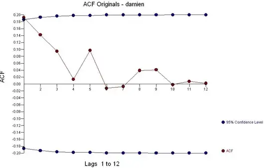

The 114 values you posted are quite different from your original plot. The actual-fit-forecast isenter image description here. The acf of the original series shows little structure enter image description here . The "best model" contains no ARIMA structure but evidences a few unusual data points and three distinct means or GROUPS [1-32 ; 33-69 ; 70-114 ] enter image description here with outliers enter image description here] .[4] . The acf of the residuals suggests randomness![enter image description here . What we have here are three arima models of the form (0,0,0)(0,0,0) with three different means or regimes XBAR1=8.0 ; XBAR2=14.826 and XBAR3=10.8572. One could consider this single-dimension cluster analysis (see Univariate clustering of time series )

    @IrishStat I see from your plot that Huber was right. his data looks nothing like the original plot even if the labelling was corrected. It does look like two level shifts with no apparent trend at all. there is one very distinctive outlier in the first portion of the series and possbly another after the second shift. My suggestions wouldn't work for this plot. Mine only pertained as possibilities to the original plot. If there was an issue with the private communication i think it is resolved as you have exhibited the data and your modeling of it very nicely for CV. – Michael R. Chernick Jul 24 '12 at 00:26
    @IrishStat it looks to me that the level shifts explain a lot of the variation, The remaining problems are the outliers and the job for the OP to come up with a sensible explanation for the apparent behavior. – Michael R. Chernick Jul 24 '12 at 00:28
