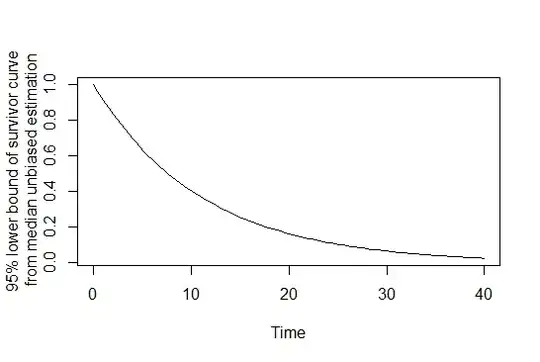

Gives an upper bound for the probability of 0.09. Median unbiased estimates are invariant to monotonic transforms so this can be transformed to a number of person years exposure by multiplying top by the number of components (10) and the bottom by the number of component-years (100) to get a rate of: 0.9 failures per 100 component years. And transforming this to an exponential distribution we get a survivor curve along the lines of:
curve(pexp(x, 0.09, lower.tail=F), xlab='Time', ylab='95% lower bound of survivor curve\n from median unbiased estimation', xlim=c(0, 40))
