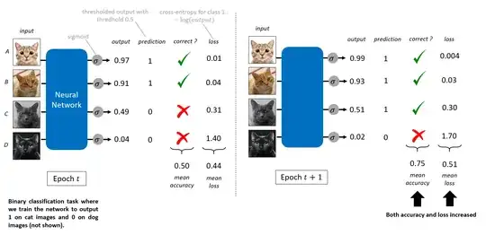

Let's consider the case of binary classification, where the task is to predict whether an image is a cat or a dog, and the output of the network is a sigmoid (outputting a float between 0 and 1), where we train the network to output 1 if the image is one of a cat and 0 otherwise. In this case, two phenomenons can happen at the same time :
  1. Some images with borderline predictions get predicted better and so their output class changes to the correct one (image C in the figure). This is the classic "loss decreases while accuracy increases" behavior that we expect when training is going well.
  2. Some images with very bad predictions keep getting worse (image D). This leads to a less classic "loss increases while accuracy stays the same".
    You might think that this effect should be "countered" by the inverse phenomenon of images with very good predictions getting better (images A and B, note that their output has increased the same amount than the one of image D has decreased (0.02)). However, when using cross-entropy loss for classification (as it is usually done), bad predictions are penalized much more strongly than good predictions are rewarded. For a cat image (ground truth : 1), the loss is $-log(output)$, so slightly better predictions for images already close to 1 don't change the mean loss much (as the difference between log(<number close to 1>) and log(<number slightly closer to 1>) is low), while a single misclassified cat image getting worse can "blow up" your mean loss (as the difference between log(<number close to 0>) and log(<number slightly closer to 0>) is high). See this answer for further illustration of this phenomenon.
    (Getting increasing loss and stable accuracy could also be caused by good predictions being classified a little worse, but I find it less likely because of this loss "asymmetry").
So I think that when both accuracy and loss are increasing, the network is starting to overfit, and both phenomena are happening at the same time. The network is starting to learn patterns only relevant for the training set and not great for generalization, leading to phenomenon 2 where some images from the validation set get predicted really wrong (image D), with an effect amplified by the "loss asymmetry". However, it is at the same time still learning some patterns which are useful for generalization (phenomenon one, "good learning") as more and more images are being correctly classified (images A, B, C).
I sadly have no answer for whether or not this "overfitting" is a bad thing in this case: should we stop the learning once the network is starting to learn spurious patterns, even though it's continuing to learn useful ones along the way?
