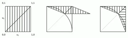

I propose the following solution, that should be simpler, more efficient and/or computationally cheaper than other soutions by @cardinal, @whuber and @stephan-kolassa so far.
It involves the following simple steps:
1) Draw two standard uniform samples: $$ u_1 \sim Unif(0,1)\\ u_2 \sim Unif(0,1). $$
2a) Apply the following shear transformation to the point $\min\{u_1,u_2\}, \max\{u_1,u_2\}$ (points in the lower right triangle are reflected to the upper left triangle and they will be "un-reflected" in 2b): $$ \begin{bmatrix} x\\y \end{bmatrix} = \begin{bmatrix} 1\\1 \end{bmatrix} + \begin{bmatrix} \frac{\sqrt{2}}{2} & -1\\ \frac{\sqrt{2}}{2} - 1 & 0\\ \end{bmatrix} \, \begin{bmatrix} \min\{u_1,u_2\}\\ \max\{u_1,u_2\}\\ \end{bmatrix}. $$
2b) Swap $x$ and $y$ if $u_1 > u_2$.
3) Reject the sample if inside the unit circle (acceptance should be around 72%), i.e.: $$ x^2 + y^2 < 1. $$
The intuition behind this algorithm is shown in the figure.
Steps 2a and 2b can be merged into a single step:
2) Apply shear transformation and swap $$ x = 1 + \frac{\sqrt{2}}{2} \min(u_1, u_2) - u_2\\ y = 1 + \frac{\sqrt{2}}{2} \min(u_1, u_2) - u_1 $$
