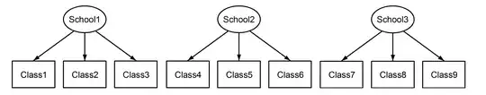

The dataset in your example is rather large, so I will use another schools example from the internet to explain the issues. But first, consider the following over-simplified example:
Here we have classes nested in schools, which is a familiar scenario. The important point here is that, between each school, the classes have the same identifier, even though they are distinct if they are nested. Class1 appears in School1, School2 and School3. However if the data are nested then Class1 in School1 is not the same unit of measurement as Class1 in School2 and School3. If they were the same, then we would have this situation:
which means that every class belongs to every school. The former is a nested design, and the latter is a crossed design (some might also call it multiple membership. Edit: For a discussion of the differences between multiple membership and crossed random effects, see here ), and we would formulate these in lme4 using:
(1|School/Class) or equivalently (1|School) + (1|Class:School)
and
(1|School) + (1|Class)
respectively. Due to the ambiguity of whether there is nesting or crossing of random effects, it is very important to specify the model correctly as these models will produce different results, as we shall show below. Moreover, it is not possible to know, just by inspecting the data, whether we have nested or crossed random effects. This can only be determined with knowledge of the data and the experimental design.
But first let us consider a case where the Class variable is coded uniquely across schools:
There is no longer any ambiguity concerning nesting or crossing. The nesting is explicit. Let us now see this with an example in R, where we have 6 schools (labelled I-VI) and 4 classes within each school (labelled a to d):
