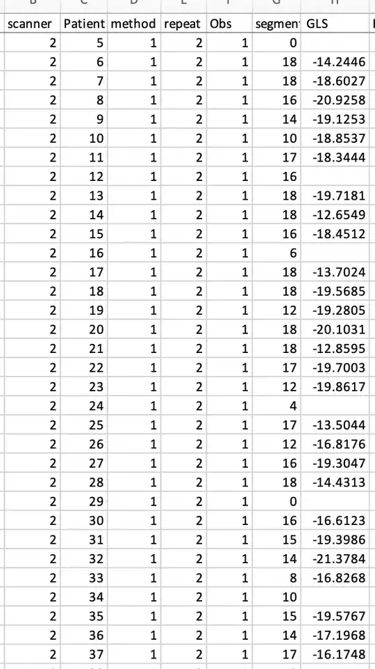

i have ultrasound data measuring strain of myocardium as the dependant variable. Now i want to compare reliability and agreement of the measurement system between the 2 methods, the test retest and the difference between observers. i am using a LMM to calculate repeatability coeff (2.77 * within patient SD) and ICC (within pat SD / (within pat SD + between pat SD).
I have several factors : patient (1-40), observors (1,2), Method (1,2), scanner (1,2). I am not completely sure how to model this, i know from what i read that the patient should be the random clustering variable, but if seems if i am to calculate ICC and RC's above i have to have observer as a random factor to proportion the variance. does anyone have experience with this type of model? enter image description here

  • I am using jamovi btw which is lme4 based. So i mean the largest r2 and the lowest AIC/BIC to indicate model fit, but im not sure if this is appropriate either. so i have the patient as a random factor/ grouping variable, plus the observer and scanner also as random effects. this is based on 2 separate models for each method. so my longitudinal data headers are : Patient,Scanner, Obs, GLS AFI,GLS 2DS. – K S Oct 06 '20 at 11:21

  • 2 scanners, 2 different observors, and there is about 40 patients. – K S Oct 06 '20 at 11:33

  • this is what the r call looks like for one method: gls 2ds ~ 1 + scanner.+( 1 + Observer. | Patient. ). i think the patient is the intercept, – K S Oct 06 '20 at 11:38

  • sorry that was the wrong model : this one , Gls afi ~ 1 +( 1 + Observer. + scanner. | Patient. ) – K S Oct 06 '20 at 11:45
