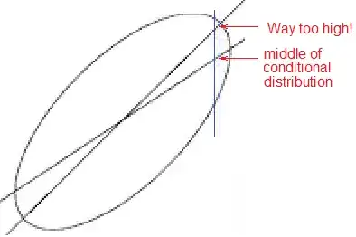

This sort of "problem" occurs quite naturally and can look this way without actually indicating a problem. (There might be some problem, but a pattern similar to this doesn't necessarily indicate one.)
It's a consequence of regression to the mean and arises directly out of fitting the conditional mean (i.e. it's exactly what you expect to see with regression).
One thing that might throw off some answerers is that you have your plot "backward" to what most of us are used to -- with the random variable on the x axis rather than the y-axis.
Here I have generated some data according to a regression model (with a normally distributed predictor and conditionally normal response) and fitted a model of the same form as the one that generated the data. Here's the corresponding plot to yours drawn the other way around:
Looking at the slice between the blue lines, the red line (which is just the line with slope 1 and intercept 0) passes very near the mean of the $y$ in that slice. That is, $\hat{y}\approx E(Y|x)$.
You are asking if you should "tweak" your line to lay closer to the major axis of the roughly elliptical point cloud ... but that is not going to be the "best fit" line, and will tend to overpredict the mean for large $y$ values and underpredict it for small y values.
If the regression assumptions are reasonable, and assuming you actually want to predict $E(Y|x)$, then there's nothing wrong here -- you see exactly what you should.
A case where you might see something like this, and where it might be an issue:
However, if your line at the edge of the cloud doesn't pass near the middle of small slices (vertical ones in my case) that might indicate that you have some underprediction (such as might occur if you're shrinking coefficients).
That may or may not be a problem: shrinking coefficients toward zero is often quite useful; that will lead to bias but bias isn't the whole story of fitting.
A small amount of bias toward zero (shrinkage) in the coefficients will produce a slightly "shallower" fit than the least squares line (on my plot; steeper on yours). That's not necessarily a problem at all.
It's only if the bias is larger than you want it to be that there would be any need to act at all. Otherwise it could still be doing exactly what it should.
So I don't see a problem here -- it looks to me like your model is doing what it should.

  • It would help if we could get the figure presented better, but I wonder if this is the opposite of regression to the mean. The data are spreading over a wider range than the predictions. – gung - Reinstate Monica Jul 28 '16 at 12:25
    @gung That's how regression to the mean always works. The predictions are less spread than the data – Glen_b Jul 28 '16 at 12:57
  • @gung I have added a version of the plot from the question with axes interchanged. (I can't change the ratio of height and width without scraping data from the plot though -- not something to do today). – Glen_b Jul 28 '16 at 13:23
  • There is a confusion here (which may be mine). The way I think about regression to the mean is illustrated in my answer to Algorithms for automatic model selection: When you select based on a value, future values will be closer to the mean than what you picked. The data in the graph are further from the mean, AFAICT. Alternatively, the fitted slope is closer to 0 than the appropriate slope in the test set. This makes sense as RttM if slopes were selected by being closer to 0, but I gather that isn't what the OP did. – gung - Reinstate Monica Jul 28 '16 at 21:47
  • @gung Regression to the mean occurs because $E(Y|X)-E(Y)$ is on average smaller in magnitude than $Y-E(Y)$ (e.g. mean-square sense). Say we have $E(Y|X)$ linear in $X$, so it is the linear regression line. See Senn's figures with Galton's data in figure 1 here (the dashed red lines are the regression lines, solid red are LOWESS curves). There (as is the case in Galton's own work) regression to the mean is illustrated by the fact that the regression line is closer to the mean (smaller slope) ...ctd – Glen_b Jul 28 '16 at 22:27
  • ctd... than the major axis of the ellipse, and as I illustrated this is exactly what it should do; the major axis doesn't correspond to the conditional mean (i.e. regression gives us what it should, a fit that has that "regression to the mean" effect, where the fit is closer to the mean than the data). You're certainly free to argue that I shouldn't call the fact that $E(Y|X)-E(Y)$ is on average smaller in magnitude than $Y-E(Y)$ "regression to the mean" in this particular instance, but whatever you call it, it's the same aspect of conditional expectation in regression. – Glen_b Jul 28 '16 at 22:29
  • I certainly agree with all that. I agree with your elipse figure & simulation figure. So when you said it looked like RttM, you meant that it looked like the line was tracing out the conditional means. Fair enough. When I said it looked too shallow, I meant that the line looks closer to the grand mean than the conditional mean is at each point in X. I could still be wrong here; it would be helpful if we got more information. – gung - Reinstate Monica Jul 28 '16 at 23:23
  • @gung Oh, I think you're correct on that -- once I flipped the original plot about it became pretty clear to me that it must be so (I wasn't nearly as sure before I did that). – Glen_b Jul 29 '16 at 00:08
  • @Glen_b Can we apply the same strategy to https://stats.stackexchange.com/questions/502591/why-is-the-predicted-value-rotated-version-of-the-actual-value question? – newbie Dec 28 '20 at 04:20
  • It looks like it is the same issue. – Glen_b Dec 29 '20 at 11:22
