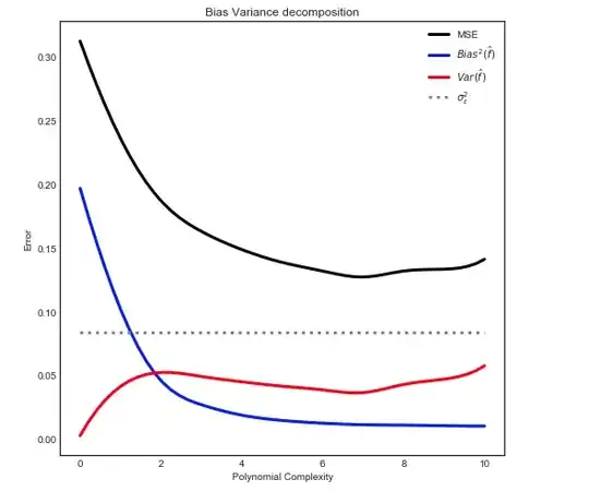

 Bias - Variance Decomposition
As explained here the MSE can be broken down into 3 main components:
$$E[ (Y - \hat f)^2 ] = \sigma^2_\epsilon + Bias^2[\hat f] + Var[\hat f]$$ $$E[ (Y - \hat f)^2 ] = \sigma^2_\epsilon + \left[ f - E[\hat f] \right]^2 + E\left[ \hat f - E[ \hat f] \right]^2$$
Where in our toy case:
  • $f$ is known from the initial dataset
  • $\sigma^2_\epsilon $ is known from the uniform distribution of $\epsilon$
  • $E[\hat f]$ can be computed as above
  • $\hat f$ corresponds to a lightly colored line
  • $E\left[ \hat f - E[ \hat f] \right]^2$ can be estimated by taking the average
Giving the following relation
Note: the graph above uses the training data to fit the model and then calculates the MSE on train + test.
