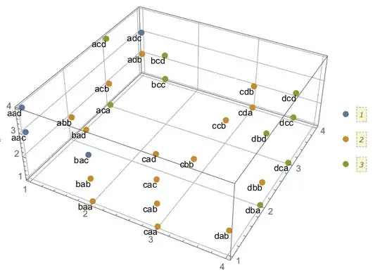

If we replace every character with an integer we can see from this plot how the clusters are formed with Hamming distance:
esrules = Thread[chs -> Range[Length[chs]]]; gr1 =
 ListPointPlot3D[Characters[cls] /. esrules,
  PlotStyle -> {PointSize[0.02]}, PlotLegends -> Automatic,
  FaceGrids -> {Bottom, Left, Back}];
gr2 = Graphics3D[
   Map[Text[#, Characters[#] /. esrules, {1, 1}] &, Flatten[cls]]];
Show[gr1, gr2]

  • So you have "clusters" here. But are they meaningful? Are they better than other clusters? From the plot, I'd say cluster 1 is pretty random. So why is that a cluster? – Has QUIT--Anony-Mousse Jun 14 '16 at 00:19
  • @Anony-Mousse I should have labeled the points with the corresponding words -- I updated my answer with such a plot. From that plot it should be obvious that cluster 1 is a very strong one from the Hamming distance perspective -- each point has at least one neighbor with distance one. Also, I forced FindClusters to find three clusters, this partially explains what we see. I could have used another, more illustrative clustering algorithm for this example. – Anton Antonov Jun 14 '16 at 03:39
  • Why is adc in cluster 1, and not in cluster 2 (which contains adb?) I realize now that the coordinates are meaningless, and the 4 could be a 0, too. But you see: it's rather arbitrary which clister contains adc, adb etc. – Has QUIT--Anony-Mousse Jun 14 '16 at 04:54
  • @Anony-Mousse The coordinates are not "meaningless" - the mapping from character to integer is obvious. I will show you a better layout of the clusters tomorrow, hopefully your questions I that regard will be satisfied... – Anton Antonov Jun 14 '16 at 05:27
  • They are meaningless/misleading in the sense that the difference of 4 to 1 is 1. – Has QUIT--Anony-Mousse Jun 14 '16 at 05:30
  • @Anony-Mousse The mapping from the Hamming distance space to the Euclidean space can be confusing. See my update, I made a distance graph and a related clustering. As I mentioned in my previous comment, the community graph should give you enough clarity about the clusters. – Anton Antonov Jun 14 '16 at 14:04
  • Can you post the matrix of Hamming distances? Also, what is the algorithm of clustering you used? How does it work? – ttnphns Jun 14 '16 at 14:05
  • I think this is interesting. I was able to replicate your clustering using PAM & the edit distances for your data. I find that I share @Anony-Mousse's concerns, though. I think the crux of it is that there appear to be no actual clusters in the data generating process. These are just purely random letter combinations. It happens that the edit distances between them yield clusters, but that seems to be entirely happenstance. – gung - Reinstate Monica Jun 14 '16 at 21:33

  • @gung, I ultimately think it is impossible to have zero or low chi-sq association and anyhow clear clusters at the same time (so I deleted my answer). Obviously, clear clusters with nominal variables mean that in the frequency rXc cross-table there must exist (or be achievable via row or column reordering) a diagonal structure in the table formed by some high-frequency cells. That is incompatible with the absence of chi-square association. – ttnphns Jun 16 '16 at 11:00
  • @ttnphns if we allow arbitrary row-column reorderings of a contingency matrix then we can find clusters in almost any dataset, since you can search the space of row-column swaps to maximize the chi-square statistic. This will induce an arbitrary metric in the space of categorical outcomes. Such clusters will likely be spurious. –  Jun 16 '16 at 11:55

    @Bey, there are, of course, many other possible distance and association measures for categorical data, so you're free to suggest something esoteric that makes it work. – gung - Reinstate Monica Jun 16 '16 at 13:31
