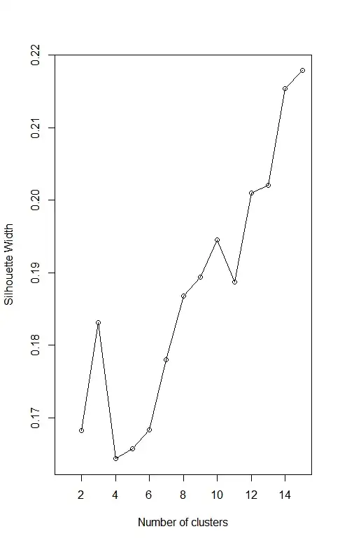

I am running a mixed type data cluster analysis in R and I am trying to interpret the Silhouette Plot. For whatever reason, it is telling me that more clusters is ideal for analysis. Why could this be? I am using a sample of 10k with 6 variables (4 of which are categorical). enter image description here

    Your Silhouette values are very low. Actually, the plot tells that you have no clusters. Range between .17 and .22 is so narrow: your line approaches straight line. Smooth line of any clustering criterion, even if it is not horizontal, should be interpreted as "no clear clusters". – ttnphns Dec 30 '17 at 09:51

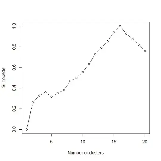

Let me go through an example of that using just four binary categorical variables, ignoring your continuous variables. I generate some data, cluster the data using PAM on Gower distance and various values for the number of clusters. I compute the silhouette and plot the results, obtaining a graph not dissimilar from yours. Spoiler alert! The process produces misleading results.

plot(c(0,SIL), type="b")
Plot of Silhouette values
I set the random seed to get a fully reproducible result, but I suggest running this a few times without the setting the seed to see that you (almost) always get a graph that peaks at 16 clusters. That must be the right number of clusters, right? No way! Notice that I generated the data at random. This is what uniform random data looks like. So why does the "silhouette method" give a clear answer of 16 clusters?

Given two points, they can disagree in 0,1,2,3 or 4 coordinates. Gower distance normalizes this to distances of 0, ¼, ½, ¾ or 1. These are the only possible distance values. With 4 binary categorical variables, there are 16 possible vector values. If all points with the same vector of four values are in the same cluster, then they all have distance zero from each other and distance at least 0.25 from any other point. This will make the silhouette a "perfect" 1 with 16 clusters. But again, this example is just random data. These clusters are not meaningful. For every point, the points at distance 0.25 are in another cluster even though no smaller distance between unequal points is possible. The discretization of distances encourages every distinct value to be treated as its own cluster.
I think this is what you are seeing in your graph. Of course, I am not looking at your categorical variables and I am ignoring any effect of the continuous ones. I don't even know if your categorical variables are binary or could have multiple values. But here is something worth trying. Compute the number of possible combinations of your categorical variables. If your variables are binary you should get 16. If they are not not binary, use

Notice that within each cluster, the categorical variable takes on only one value. This works with all four categorical variables. The clusters are determined by the four variables. Even including your continuous variables, does that happen with your data? If so, the discretized categorical variables are dominating the clustering process and this separation may not mean much. When you include the continuous variables, the distances won't be strictly discretized, but may fall into groups based only on the categorical variables.

Silhouette values less than 0.4 are bad.
So none of your clusterings worked well. The clusters are not reliable. You probably need to use a different algorithm, metric, or your data might not contain any clusters at all (categoricial data frequently does not contain clusters).
P.S. Silhouette plot commonly refers to a plot showing the Silhouette of each point in just one data set, not parameter k vs. average Silhouette like you used for plotting.
  • Completely agree with the first. As for terminology, it is ok to call the OP's plot (average) Silhouette criterion plot, while what you refer to is called Silhouette Width plot. – ttnphns Dec 30 '17 at 09:55
