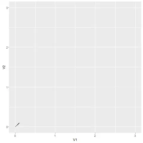

but I think this implementation is somehow wrong because when I tried to perform gradient descent order I algorithm to estimate coefficients in the Cox proportional model for artificial data (generation based on How to create a toy survival (time to event) data with right censoring) I received results that are far from real coefficients beta = c(2,2) from which I have generated data

enter image description here enter image description here enter image description here enter image description here enter image description here enter image description here enter image description here enter image description here
I mean estimation process stops for $\beta$'s that are not even close to beta=c(2,2). My question is where is a mistake in the philosophy or implementation or is there a simpler way to compute gradient for partial log-likelihood in Cox proportional hazards model?

Try this:
batchData <- preparedData
batchData <- batchData %>% arrange(-times)
  scores <- apply(batchData[, -c(1, 2)], MARGIN = 1,
                  function(element) {
                    exp(element %*% beta)
  nominator <- apply(batchData[, -c(1, 2)], 2, function(x) cumsum(scores*x))
  denominator <- cumsum(scores)
  partial_sum <- (batchData[, -c(1, 2)] - nominator/denominator)*batchData[, "event"]
  U_batch <- partial_sum %>% colSums()
langusta
