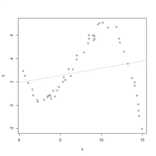

Here is a simple example (coded in R). Hopefully the image is sufficiently obvious to explain how a nonlinear relationship (not model), when fit with a linear relationship, yields regions with predicted values that are systematically overestimated and underestimated.
set.seed(7439)                # this makes the example exactly reproducible
x = runif(50, min=0, max=15)  # X is uniformly distributed from 0 to 15
 # this is the true data generating process:
y = 3.7 - 2.5*x + 0.56*x^2 - 0.028*x^3 + rnorm(50, mean=0, sd=.3)
model = lm(y~x)               # here I fit a model with a linear relationship
windows()
  plot(x, y)                       # this plots the data
  abline(coef(model), col="gray")  # this plots the model's predicted values

  • We can go a bit further to investigate the goodness of fit. summary(model) ... Multiple R-squared: 0.04939, Adjusted R-squared: 0.02959 F-statistic: 2.494 on 1 and 48 DF, p-value: 0.1208 You can observe the R-squared. It's too low. 2% indicates that the model explains almost none of the variability of the response data around its mean. – Mohammad Kibria Apr 20 '20 at 04:45
  • @MohammadKibria, R-squared is not goodness of fit (see Is $R^2$ useful or dangerous?). You can have the same situation as here w/ R-squared as high as you like. – gung - Reinstate Monica Apr 20 '20 at 05:52
