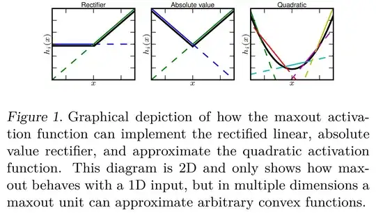

This means that the unit, viewed as a function from $\mathbb R^d$ to $\mathbb R$, is the piecewise max of affine functions. The paper's Figure 1 gives some examples of different functions it might look like:
Each of the dashed lines represents a $W^T x + b$. You can represent any convex function in this way, which is pretty nice.

  • Would it be accurate to say that you can model this using k multiple connections between each pair of connected neurons (rather than a single connection as is normally done), calculating k activations for each pair and then selecting the top one as the winner? Or is it sometimes necessary to use separate biases for each sub-connection, thereby making it necessary to model each connection as if it belong to a different sub-neuron? – SQLServerSteve Jul 29 '16 at 02:42
    @SQLServerSteve Each of the $k$ connections can have different biases (this is necessary e.g. for the "quadratic" in the picture above). But you can still think about it in the way you described, you just also have to also add in a bias for each of the connections. Sometimes people talk about an imaginary "bias unit" that always outputs 1; in that case, your model works fine as long as the bias unit also has multiple connections. – Danica Jul 29 '16 at 02:49
