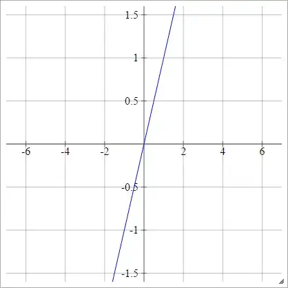

Identity
Also known as a linear activation function.
$$a^i_j = \sigma(z^i_j) = z^i_j$$
Identity

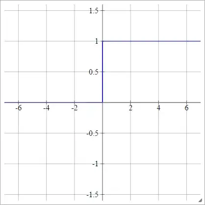

Step
$$a^i_j = \sigma(z^i_j) = \begin{cases} 0 & \text{if } z^i_j < 0 \\ 1 & \text{if } z^i_j > 0 \end{cases}$$
Step

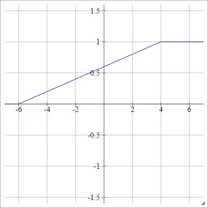

Piecewise Linear
Choose some $x_{\min}$ and $x_{\max}$, which is our "range". Everything less than than this range will be 0, and everything greater than this range will be 1. Anything else is linearly-interpolated between. Formally:
$$a^i_j = \sigma(z^i_j) = \begin{cases} 0 & \text{if } z^i_j < x_{\min} \\ m z^i_j+b & \text{if } x_{\min} \leq z^i_j \leq x_{\max} \\ 1 & \text{if } z^i_j > x_{\max} \end{cases}$$
Where
$$m = \frac{1}{x_{\max}-x_{\min}}$$
and
$$b = -m x_{\min} = 1 - m x_{\max}$$
Piecewise Linear

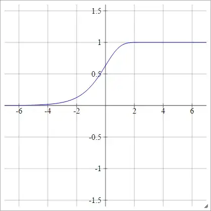

Sigmoid
$$a^i_j = \sigma(z^i_j) = \frac{1}{1+\exp(-z^i_j)}$$
Sigmoid
Complementary log-log
$$a^i_j = \sigma(z^i_j) = 1 − \exp\!\big(−\exp(z^i_j)\big)$$

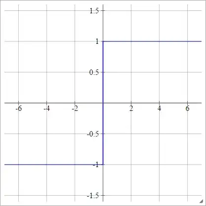

Bipolar
$$a^i_j = \sigma(z^i_j) = \begin{cases} -1 & \text{if } z^i_j < 0 \\ \ \ \ 1 & \text{if } z^i_j > 0 \end{cases}$$
Bipolar

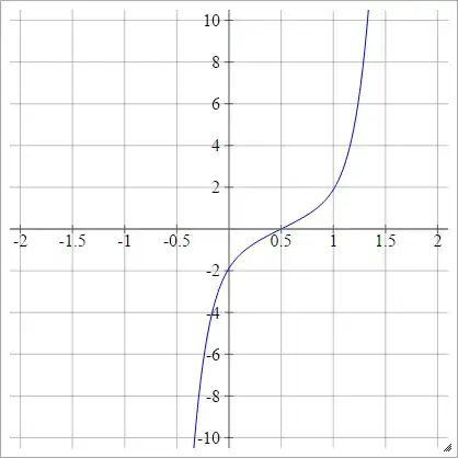

Absolute
$$a^i_j = \sigma(z^i_j) = \mid z^i_j \mid$$
Absolute

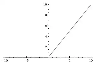

Rectifier
Also known as Rectified Linear Unit (ReLU), Max, or the Ramp Function.
$$a^i_j = \sigma(z^i_j) = \max(0, z^i_j)$$
Rectifier

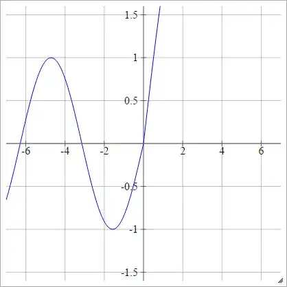

$$a^i_j = \sigma(z^i_j) = \max(0, z^i_j)+\sin(z^i_j)$$
ReLU sin
Scaled:
ReLU sin scaled

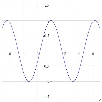

Cosine
See Random Kitchen Sinks.
$$a^i_j = \sigma(z^i_j) = \cos(z^i_j)$$.
Cosine

Left: Rectified Linear Unit (ReLU) activation function, which is zero when x &lt 0 and then linear with slope 1 when x &gt 0. Right: A plot from Krizhevsky et al. (pdf) paper indicating the 6x improvement in convergence with the ReLU unit compared to the tanh unit.
ReLU. The Rectified Linear Unit has become very popular in the last few years. It computes the function $f(x) = \max(0, x)$. In other words, the activation is simply thresholded at zero (see image above on the left). There are several pros and cons to using the ReLUs:
  • (+) It was found to greatly accelerate (e.g. a factor of 6 in Krizhevsky et al.) the convergence of stochastic gradient descent compared to the sigmoid/tanh functions. It is argued that this is due to its linear, non-saturating form.
  • (+) Compared to tanh/sigmoid neurons that involve expensive operations (exponentials, etc.), the ReLU can be implemented by simply thresholding a matrix of activations at zero.
  • (-) Unfortunately, ReLU units can be fragile during training and can "die". For example, a large gradient flowing through a ReLU neuron could cause the weights to update in such a way that the neuron will never activate on any datapoint again. If this happens, then the gradient flowing through the unit will forever be zero from that point on. That is, the ReLU units can irreversibly die during training since they can get knocked off the data manifold. For example, you may find that as much as 40% of your network can be "dead" (i.e. neurons that never activate across the entire training dataset) if the learning rate is set too high. With a proper setting of the learning rate this is less frequently an issue.
