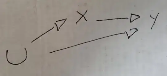

You want to estimate the true causal effect of $X$ on $Y$. You are asking this question:
But you might remember, when first learning about causality and causal confounders, that an unmeasured prior cause of $X$ and $Y$, say, $U$, will confound $E(Y|X)$ as an unbiased estimator of the true causal effect of $X$ on $Y$.
If "the explanatory variable can be explained by the variable you are trying to explain" then you have a situation where past values of $Y$ cause current values of $X$, which then may in turn cause future value of $Y$. If we make time explicit in our causal graphs, you can see how past values of $Y$ confound probability of future values of $Y$ conditional on current values of $X$ (assuming that past values of $Y$ cause future values of $Y$ via some pathway not involving $X$):
So can you just condition on $Y_{t=1}$ to eliminate this confounding? No, because there will be values of $X$ and $Y$ farther in the past that will bias the conditioning on $Y_{t=1}$ (for example). This is why instrumental variables are so cool (when you can find them):
Notice that $Z$ is not caused by past values of $X$ or $Y$ (the dotted arrow suggests that $Y$ is so confounded by past values), so $E(Y_{t=3}|\hat{X}_{t=2})$, where $\hat{X}_{t=2} = E(X_{t=2}|Z_{t=1})$ is an unbiased estimator of the true causal effect of $X_{t=2}$ on $Y_{t=3}$ (if the causal assumption that $Z_{t=1}$ causes $Y_{t=3}$ only through $X_{t=2}$ holds).
Elaborations on the model could, naturally generalize to $X$ and $Y$ at many times.

  • Very cool way to put it, in terms of a time series. From the wikipedia, "Bias is related to consistency as follows: a sequence of estimators is consistent if and only if it converges to a value and the bias converges to zero." So, the problem is that, as I increase my sample, the parameters estimated in my model may vary widely, is that so? Is that why having these problems in mind when choosing the estimator is a good idea? (Also, just to finish off hehe, what hypothesis test would be good to prevent this? (I mean, to know whether there could be causality issues.)) – Ricardo Cruz Mar 25 '15 at 19:45
    @RicardoCruz I don't think of it in terms of "vary widely" but in terms of bias (sample size does not correct bias from causal confounding). As to what model (not test) will correct for this bias, you said it yourself: instrumental variables models! Also: if you like my answer please feel free to vote on it by clicking the up-arrow. You ought to also click the check mark next to the answer that you feel best answers your question (if any). Since I am not in economics I can;t suggest good instrument(s) for your variables. – Alexis Mar 25 '15 at 19:49
  • Thank you, Alexis. So, I think my confusion was that the term inconsistency to me means that my parameter estimation may vary according to sample size (ie. if I run OLS with a given sample, I get a certain beta vector, but if I run it with another sample may get a very different beta vector). I thought it was inconsistent because it did not converge. You are saying it is inconsistent because it is unbiased. The two conditions are necessary for consistency, and my confusion was that I thought the first was the problem here. – Ricardo Cruz Mar 25 '15 at 19:55
  • @RicardoCruz biased not unbiased. :) – Alexis Mar 25 '15 at 19:58
  • Just one thing: what does it mean in practice the model being biased, as long as it seems to have good prediction value in the validation tests? – Ricardo Cruz Mar 25 '15 at 20:04
  • Yes biased hehe, English is not my native language. – Ricardo Cruz Mar 25 '15 at 20:04
  • Btw, what is a good test to identify this kinda of problems? I seem to remember Wald test, is that a good one? – Ricardo Cruz Mar 25 '15 at 20:08
