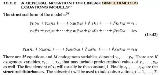

The simultaneity induces simultaneous equations bias. It seems you're fine with this link, and simply want a formal definition of simultaneous equations model to start with. It can be found in multiple econometrics textbooks. Here's a snippet from the chapter in Greene's 7th edition:
The system 10-42 above is the definition of simultaneous equations model. You can find all the details in the textbook, of course. You can recognize the system in your question as a special case of Eq.10-42
I suppose it's called simultaneous because you have to determine all $y_i$ at once, not one after another. However, it's more nuanced than that. For instance, seemingly unrelated regressions look quite similar to this model (except no endogenous variables on the right side), and they don't have the same endogeneity issues.
