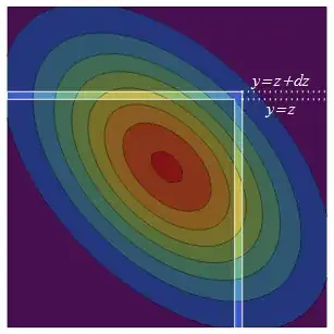

Let $f_\rho$ be the bivariate Normal PDF for $(X,Y)$ with standard marginals and correlation $\rho$. The CDF of the maximum is, by definition,
$$\Pr(\max(X, Y)\le z) = \Pr(X\le z,\ Y\le z) = \int_{-\infty}^z\int_{-\infty}^z f_\rho(x,y)dy dx.$$
The bivariate Normal PDF is symmetric (via reflection) around the diagonal. Thus, increasing $z$ to $z+dz$ adds two strips of equivalent probability to the original semi-infinite square: the infinitesimally thick upper one is $(-\infty, z]\times (z, z+dz]$ while its reflected counterpart, the right-hand strip, is $(z, z+dz]\times (-\infty, z]$.
Figure
The probability density of the right-hand strip is the density of $X$ at $z$ times the total conditional probability that $Y$ is in the strip, $\Pr(Y\le z\,|\, X=z)$. The conditional distribution of $Y$ is always Normal, so to find this total conditional probability we only need the mean and variance. The conditional mean of $Y$ at $X$ is the regression prediction $\rho X$ and the conditional variance is the "unexplained" variance $\text{var}(Y) - \text{var}(\rho X) = 1-\rho^2$.
Now that we know the conditional mean and variance, the conditional CDF of $Y$ given $X$ can be obtained by standardizing $Y$ and applying the standard Normal CDF $\Phi$:
$$\Pr(Y \le y\,|\, X) = \Phi\left(\frac{y-\rho X}{\sqrt{1-\rho^2}}\right).$$
Evaluating this at $y=z$ and $X=z$ and multiplying by the density of $X$ at $z$ (a standard Normal pdf $\phi$) gives the probability density of the second (right-hand) strip
$$\phi(z)\Phi\left(\frac{z-\rho z}{\sqrt{1-\rho^2}}\right) = \phi(z)\Phi\left(\frac{1-\rho}{\sqrt{1-\rho^2}}z\right).$$
Doubling this accounts for the equi-probable upper strip, giving the PDF of the maximum as
$$\frac{d}{dz}\Pr(\max(X,Y)\le z) = \color{blue}{2}\color{black}{\phi(z)}\color{darkred}{\Phi\left(\frac{1-\rho}{\sqrt{1-\rho^2}}z\right)}.$$
Recapitulation
I have colored the factors to signify their origins: $\color{blue}2$ for the two symmetrical strips; $\color{black}{\phi(z)}$ for the infinitesimal strip widths; and $\color{darkred}{\Phi\left(\cdots\right)}$ for the strip lengths. The argument of the latter, $\frac{1-\rho}{\sqrt{1-\rho^2}}z$, is just a standardized version of $Y=z$ conditional on $X=z$.
