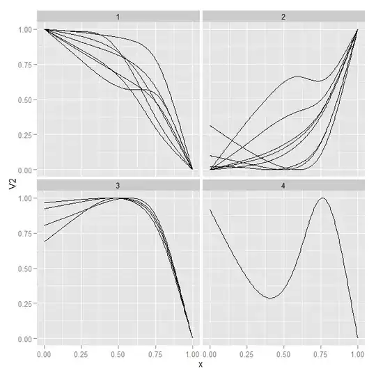

One point that Stephen Kosslyn makes in his books is that it isn't how many different lines make the plot complicated, it is how many different types of shapes the lines can take. If 20 panels end up being too small, you can frequently reduce the set to similar trajectories to place in the same panel. It is still hard to distinguish between the lines within the panels, by definition they will be nearby each over and overlap frequently, but it reduces the complexity of making between panel comparisons quite a bit. Here I arbitrarily reduced the 20 lines into 4 separate groupings. This has the added benefit that direct labelling of lines is simpler, there is more space within the panels.
###############1,2,3,4,5,6,7,8,9,10,11,12,13,14,15,16,17,18,19,20
newLevels <- c(1,1,2,2,2,2,2,1,1, 2, 3, 3, 3, 3, 2, 4, 1, 1, 2, 1)
MyData$idGroup <- factor(newLevels[MyData$id])
p3 <- ggplot(data = MyData, aes(x = x, y = V2, group = id)) + geom_line() +
facet_wrap(~idGroup)
p3
