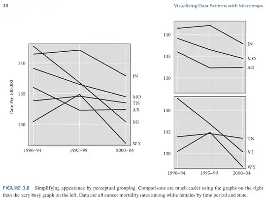

Often color is not needed in line plots with only a few lines, and different point symbols and/or dash patterns are effective enough. A more common problem with line plots is that if the lines frequently overlap it will be difficult to distinguish different patterns no matter what symbols or color you use. Stephen Kosslyn recommends a general rule of thumb for only having 4 lines in a plot. If you have more consider splitting the lines into a series of small multiple plots. Here is an example showing the recommendation
No color needed and the labels are more than sufficient.
6Thanks for the recommendation of ColorBrewer! That's the kind of thing I was looking for. – Daisy Sophia Hollman Oct 08 '14 at 16:27
The greyscale image doesn't work if there are two series with the same value either in the middle somewhere (the two series can't be traced back past that point), or at the end (the labels will not be able to distinguish which series is which). It's great when it works though... – naught101 Dec 23 '16 at 03:21
Agree @naught101 for the middle (the ends coincident just put the label somewhere before the end). It is one reason to actually not use linear interpolation between points, but use some type of spline. In that case the spline will curve in different directions. That happens quite alot in dense parallel coordinate plots. (Jittering can also help with data with many ties, like low integer count data.) – Andy W Dec 23 '16 at 14:59
1Even then, it could still happen, if the slopes are the same. Less likely, sure. Also, I think splines can sometimes give a false impression that they are based on more data than they actually are, and worse, can give a really wrong impression of the trend at the end of the time-series. But yeah, everything like this is probably going to have to be assessed on a case-by-case basis for appropriateness anyway. – naught101 Dec 25 '16 at 00:47
The advice of no more than 4 lines in a plot is well intended but a counsel of perfection. It's a good maxim for presentation graphics whenever it's important that individual lines be identifiable. It's not when the goal is to see the family properties of tens or hundreds or even more lines and knowing identifiers is dispensable: superimposed lines can often serve well to show overall patterns and also what is happening in the tails. Also, it's increasingly common to have interactive graphics in which identifiers or other data pop-up on a mouse click. – Nick Cox Nov 08 '18 at 14:20
Thank you @NickCox. Agree the four advice is quite restrictive. To give Kosslyn some more credit than my note makes here, he did say it was more about the shape of the curves than individual strokes. So you can cluster lines, like here, and the graph overall is still simple to understand. (Also that was his advice for presentations, which he thought you should only go with pretty insipid charts to keep things simple.) The blog link is working for me. – Andy W Nov 09 '18 at 15:16
Indeed: it works for me too. I guess that was a transient local problem. – Nick Cox Nov 09 '18 at 15:22
