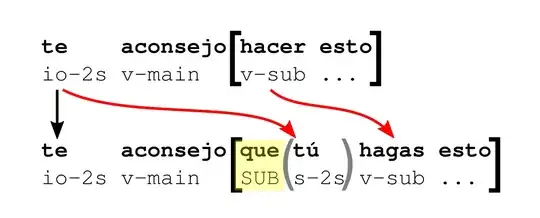

Reviving this old question, I'll focus on the first and main question: When a sentence contains two verbs with different agents must they be separated by a conjunction (e.g. que)? Or, can the second verb be in the infinitive? The answer is: it depends on the verb.
There are a number of verbs that can be followed by an infinitive, whereby the infinitive functions as a subordinate with an implicit subject that is transferred from the indirect (or dative) object of the main verb. Among these there are the "verbs of influence"
  • aconsejar ("to advise")
  • mandar ("to command")
  • prohibir ("to forbid")
  • sugerir ("to suggest")
In each case, the structure formed by the indirect object plus the main verb plus the infinitive is equivalent to that formed by the same i. o. plus the main verb plus a full subordinate set off by que in which the subject is the former indirect object and the verb is conjugated in the subjunctive mood (with the tense corresponding to that of the main verb):
  • te aconsejo hacer esto = te aconsejo que hagas esto
  • le mandé regresar = le mandé que regresara
  • nos sugieren esperar = nos sugieren que esperemos
There are other types of verbs that work this way, but I'd have no idea how to generalize, and I don't think it would be useful.
