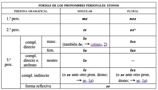

A summarized table from the RAE website shows what to use in each case:
RAE: pronombres personales átonos:
As you see les is incorrect when it is a reference to people in third person.

Like I discussed on a previous answer "Leismo" is an accepted exception (I tend not to use it but sometimes I use it), and if you come to Spain a lot of people use it (widely in the center), but 'lo' as well and most of people from South America.
Leismo de cortesia is another accepted exception (another reference from WikiLengua):
También está aceptado el llamado «leísmo de cortesía», esto es, la utilización de le/les en sustitución de lo/la y los/las cuando se refiere a usted/ustedes.
¿Quiere que le lleve hasta el restaurante? [«Leísmo de cortesía»]
¿Quiere que LO/LA lleve hasta el restaurante? [Uso CORRECTO]
But here we come again with an exception...that is why most of the books, resources for non native speakers do not mention the use of 'le', Michael Thomas has decided to put it because if you go to Spain in many areas it is used.
It is mentioned on many books because it is a real fact to be known.
If I were a foreigner I would use only lo.
