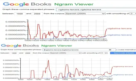

At first I thought it might just be a typo, but wanting to be sure, I decided to run it through Google's Ngram, which showed me this:
As you can see from the images above, I also tried “trigésimo/trigésima” with “tercera,” and clearly, there appears to be evidence that both are used.

Al principio, creí que podría ser un error tipográfico, pero, para estar segura, decidí pasarlo por el Ngram Viewer de Google, que me mostró esto:
[Véase la imágenes de arriba.]
Como puede verse en la imagen de arriba, también probé con “trigésimo/trigésima” y “tercera” y, claramente, parece que hay evidencia de que se utilizan ambas expresiones.

Of course, as you can see, actual usage often departs from the rule.

  • @pablodf76 Both answers here were really good, but since yours is written both in English and Spanish, and will therefore be more beneficial to a wider audience — those who are Spanish-English bilingual or semi-bilingual and those who are not or who are farther away from that end of the spectrum — you will receive the green checkmark. I especially like the fact that you addressed the Ngram by stating that usage often departs from the rule. That helps quell any notions that the less common usage is considered acceptable (outside of common/daily/colloquial usage). – Lisa Beck Feb 17 '18 at 20:59

  • @walen Tu comentario sobre lo que se usa en discurso cotidiano es definitivamente un aspecto que no había considerado así que gracias por eso. Para que conste, sin embargo, el Ngram muestra tendencias de la palabra escrita como se encuentra en libros. – Lisa Beck Feb 17 '18 at 20:49
