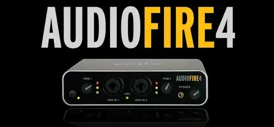

I already own an Echo AudioFire4 interface, but no mic (yet, but that´s another story) but I don´t want to carry my laptop etc. with me so I am looking for a portable solution.
Thanks for your advice!
Echo AudioFire4
(source: echoaudio.com)

For recording indoors, the Audiofire makes a usable preamp with separate gains on each mic input. You can run it without a computer, provided you use Echo's Console software to do the necessary settings first (hard pan inputs 1&2, turn phantom power on), and power it via the DC adapter.
If you go for a line-in portable recorder such as e.g. Sony PCM-M10 you can use the AF4, or another preamp (including portable) and analogue i/o. But a Microtrack or equivalent s/pdif equipped recorder makes a neat bit-bucket for the AF (remember to set sampling rates before disconnecting from computer). Finally there are XLR-input, phantom-power-capable units such as Zoom H4n, which can power microphones by themselves.
