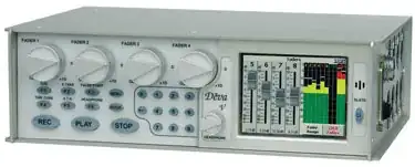

I love my Sound Devices 702. Don't have a single complaint about it. Amazing recorder, great battery life, extremely easy to use and very flexible, with an amazingly in-depth menu. Doesn't provide bias power for lavs though, so you either need to go wireless on the lav (which I'd usually do anyway) or get a dedicated power supply for the lav. I do all of my effects recording on a 702 or a Zaxcom Deva V (if I'm doing a large session with tons of mics).
Zaxcom Deva V
