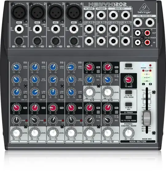

I've been looking at the Behringer Xenyx 1202 instead, but can't make out if it will do what I need.

I'm not sure that mixer can do it but you could try utilising the FX sends as a secondary mix with an output before the main mix. The output would come from the FX Send socket and you may need a headphone amp to bring it up to a usable level.
EDIT: I was looking at the wrong mixer. I don't think the Alto has FX Send capabilities but you might want to experiment with the 'Aux Out' which could be independent of the main volume. The FX Send solution could work with the Behringer but I think you'd be better off talking to a salesperson in a shop and explaining the problem you're trying to solve before committing to buy based on a post here.
