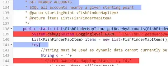

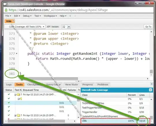

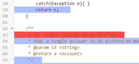

So currently the only solution I've had to accurately test the coverage of a file at any given time is:
- Destruct/delete from the sandbox server
This apparently removes it from the console's cache of some sort.
- Redeploy
- Clear All Test Data
- Re-run test
If you do not destruct/delete and redeploy then the new lines covered seem to get added to the cached version and little by little your results are distorted. As you saw in the OP screenshots this can even lead to overall code coverage issues, claiming 15/15 are covered even though the file consist of hundreds of lines.

OpportunityUtils.cls - 75% (3/4)It seems across the board there are old files in cache, but from console I can open them and see the correct version. – Xtremefaith Mar 25 '15 at 20:33
