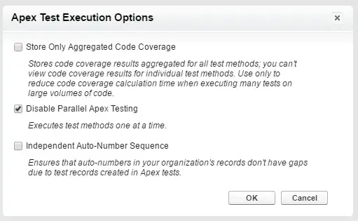

  • I logged a case with salesforce a while ago, related to code coverage issue and they suggested the following 1)Go to Apex test execution 2) clear test history 3) under options - check 'Disable Parallel Apex Testing' and uncheck 'Store Only Aggregated Code Coverage' 4) Compile all classes and then 4) Run all test – C0DEPirate Sep 14 '15 at 12:20

Distilling the comments:
  1. Clear out all the test coverage and try running it all from scratch. There can be caching issues with previous test runs. See How to eliminate bad code coverage data for apex classes ?
  2. Avoid the “Store Only Aggregated Code Coverage” option for test runs unless your volume of tests requires it.
  3. Consider disabling parallel testing. Also accessible via the Apex Test Execution Options page.
  4. Compile all the classes before running the tests.
  5. Check that the API versions for the test class and the class being tested are the same.
If those steps fail you, raise a support case with Salesforce.
