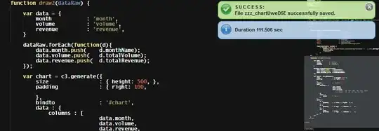

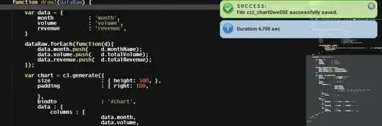

  • if we could get more insights on this category, especially on how to report or handle them efficiently without premier support, it would be great! I got for hours a performance like this enter image description here while it should be more like that enter image description here right now it's randomly fast and slow...
