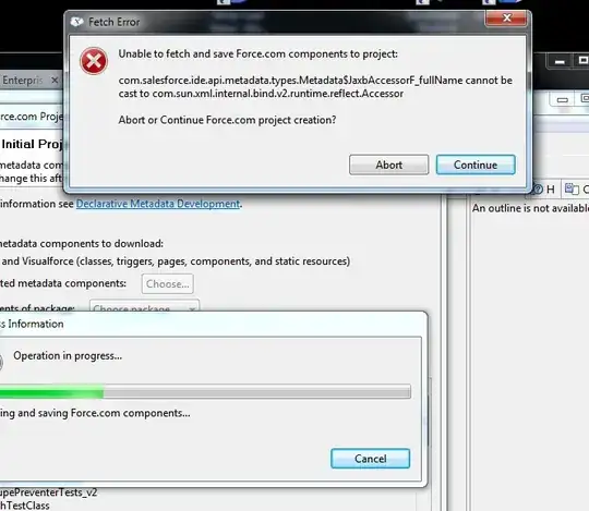

Can anyone shed some light on this error? I cannot connect to either Production OR my Sandbox with the IDE. :-( Thanks.
Screenshot of failure
This happens after entering user/pass/token in and selecting to get "all". I've tried searching keywords from the error but am coming up with no help.
Windows 7 64-bit with 64-bit IDE standalone package.

  • Can you try installing eclipse and then force.com plugin ?Or may be go for fresh installation that should be helpful – Mohith Shrivastava Dec 19 '12 at 17:44
  • Definitely related to JDK 1.7. You don't need to fully uninstall 1.7, although that's the easiest solution; alternatively, make sure that forceide.ini has a -vm switch pointing to a 1.6 JDK (in addition to the suggestion of unchecking any 1.7 JRE's inside eclipse). – jkraybill Dec 20 '12 at 05:16
5 Answers5
This error is presented (not just during deployments) when Java7 (1.7) is installed.
Removing Java7 from the machine so that Eclipse cannot reference it, should revert you back to having just the 1.6 JDK available and you'll be back in business.
Worst case, remove all installed versions of Java and then download & install JDK 1.6 again. If you're running a 32-bit version of Eclipse be sure to install the 32-bit JDK.

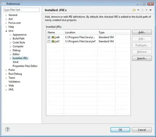

this happenns when JRE is updated from 1.6 to a higher version. The way i handle is by going to Window -> preferences in ForceIDE top menu.
another alternative is, You will get a dialog window, Click on Java ->Installed JRE and uncheck jre7. Restart ForceIDE it should work.

  • I appreciate the info. I ONLY have 7 installed at this point, and since my own solution ended up solving it (only loading classes and triggers which is what I'm working with), I'm going to stick to that for now until it becomes necessary to load more and it fails again (and I then have to go get JRE6 to install (sigh)). Thanks! – AMM Dec 20 '12 at 14:11
  • On second thought, I'll follow the advice of those who know 28x more than I do... thanks again. ;-) – AMM Dec 20 '12 at 14:21
  • For the sake of following up: JRE6 does NOT solve the problem. I switched to JRE6 solely, restarted completely IDE, and still could not load "all" from SF. But CAN load just classes and triggers. (shrug) – AMM Dec 20 '12 at 14:50
This looks to me an error because you have the latest version of jdk installed and force IDE is not compatible with it.
You can look at answer from Mark ponds and my answer with screenshot to a similar question. In Force.con IDE - Error while deploying to Server
