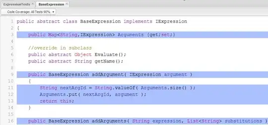

To see which lines were/were not tested see the 'Overall Code Coverage' panel on the top right, double click the class you're interested in and you'll see the output below:

    Thanks. After opening the Dev Console I noticed you can actually run the tests from there and they are executing about 10x faster (about 20-30 seconds compared to 5min+)! This is a huge help. Do you know if it's possible to get a list of which lines did not pass in the Dev Console, the way it prints out in the IDE? That's pretty important functionality for me and I don't that in the logs or anywhere else. – paul Oct 25 '12 at 05:14
    Hi @paul - I've edited my original answer to include a screenshot. There's actually much more to Dev console testing than I'd realised, good spot! – Phil Hawthorn Oct 25 '12 at 06:43
