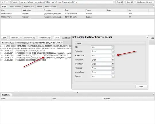

You can also set your logging level using the Developer Console, I generally use Developer Console for debugging and use the 'Open Raw Log', much easier to read I find. Leave Developer Console open whilst you run your code and you get the debug logs for free. Not sure if there is a down side to this, but I find it quicker than Monitoring->Debug Logs:

  • My only concern here is that i dont get option of none here in developer console. – Mohith Shrivastava Oct 20 '12 at 18:08
  • Yep, there is that - I guess it comes down to personal preference at the end of the day. One other + for dev console is the ability to save your perspectives, so I have one called 'log only' which only displays minimal info. – Phil Hawthorn Oct 20 '12 at 18:42

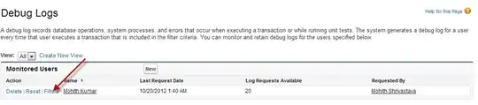

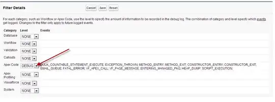

Since you may need to inspect only system.debug statements you may switch off other log categories with log levels as none except the for the Apex and you can set it to Debug.Remember log levels are cumulative as well.So debug will include erorr and Warn too.
Following snapshots may help you in figuring how to approach this

One way to reduced the log size is to adjust the logging levels. See Setting Debug Log Filters.
You could keep the Apex Code Log Level set to DEBUG and then reduce the other categories to be off.
