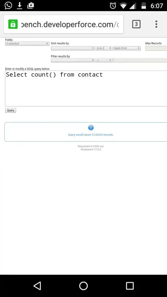

In workbench, use query as Select count() from object. It works miraculously and gives exact count quickly. That 50,000 record limitations isn't there if we query via API.
It might get timeout the first time, but if you do that for 5-6 times simultaneously in different tabs it will cache and show you data. enter image description here
  • That does indeed work very quickly (first try took 15 seconds for 500k records). The problem with Workbench is that I want to get the value from about 25 different objects, which would take a while using this method. (i.e. select the object, paste in the query, and execute each time). It is a great solution, but doesn't strictly answer the question about doing this in Apex. –  Jun 19 '16 at 02:21
  • Actually . I created a vf page that does this query job using Javascript . if it timeouts it automatically retries till success. So I could easily cache multiple objects in one go using this. Apex sync has 10sec limit nd async takes he'll lot of time. So using js nd sf rest api I achieved this. – user3209853 Jun 19 '16 at 04:22

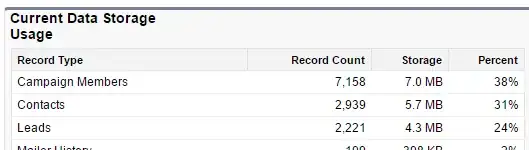

There is another path, but it is fraught with peril. And by peril, I mean screen scraping the Storage Usage Current Data Storage Usage data.

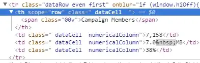

This report gives you a breakdown to Record Count by Record Type. If you drill into the html source you will see that Salesforce were even so kind as to provide the key prefix for each class on the th.
Will this be the fastest way to get the total count for a single object? Probably not. You mentioned you wanted 25 different records. At some point it may be faster to parse the Admin page that make X number of SOAP API calls.
