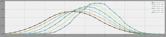

Vatine
  • 2,707
    All in all, I am not convinced this is a practical way of doing it, but it does provide an answer and looking at the result curves gives a rather vicious narrowing of the variance, as well as an increasing mean. – Vatine Dec 06 '16 at 10:14
If you really need a high middle and smaller variation with each sequential increase you can take the middle results of a odd number of die rolls. This procedure lets you achieve roughly the same mean and a small variation:
Formula: middle KEEP of ((SKILL*2)+KEEP)d10] named "Rank [SKILL]"
Result: enter image description here
http://anydice.com/program/a0a5
And if you want to increase the mean you can then add the Skill value to the result, shifting the graph to one side.
Formula: [middle KEEP of ((SKILL*2)+KEEP)d10]+ SKILL named "Rank [SKILL]"
Result:
http://anydice.com/program/a0a4

Now, other conditions and things give you "advantage" or "disadvantage" up to 3 in any direction. If you have one disadvantage, for instance, you roll your experience die twice and take the higher, then, your attribute die + skill die. If you have two disadvantages you roll experience die and attribute die twice keep the higher of those dice, each, and then roll your skill die, etc.
Here is an image of just the numbers going from 3d12 to 3d4 (there will obviously be varying combinations in between).
