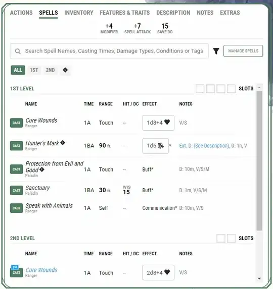

According to DnDBeyond, the first way is correct
Considering a Ranger level 3 / Paladin level 5, this character would be a Multiclass Spellcaster level 3. Doing the math: 3/2 + 5/2 = 1 + 2 = level 3, instead of (3+5)/2 = 8 / 4 = level 4.
As a Multiclass Spellcaster level 3, this character would have 4 1st-level spell slots and 2 2nd-level slots.
Some screenshots:
If we add one level to the Ranger, this character becomes a Multiclass Spellcaster level 4. Doing the equivalent math: 4/2 + 5/2 = 2 + 2 = level 4.
As a Multiclass Spellcaster level 4, this character would have 4 1st-level spell slots and 3 2nd-level slots.
