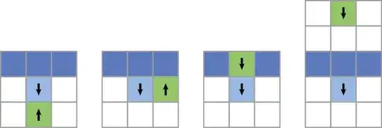

If I understand your system correctly, it will give rogues an automatic way to activate Sneak Attack:
4-step diagram of relative positions
The green character is the Rogue and the blue one is an enemy. On his turn the rogue steps two squares to get behind the enemy and turns for free. He attacks (with advantage, -2 to enemy AC, and possible more reduction due to the shield), activating Sneak Attack, and then gets to step back two more squares using his leftover movement.
On top of this you should consider things like whether a fighter can riposte to an attack done from the red zone.
