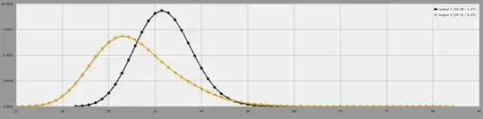

  • @Khashir, my point is that the relative damage output depends on the hit chance. Those were just two numbers I could calculate in my head. Real probability graphs look something like this (based on Miniman's answer). – Hassassin Nov 01 '14 at 11:45

I'll include the comparison graph for the sake of having something other than a link in this answer:
comparison graph
(For those who don't want to zoom in, the black line is the first build, and the orange one is the second.)
