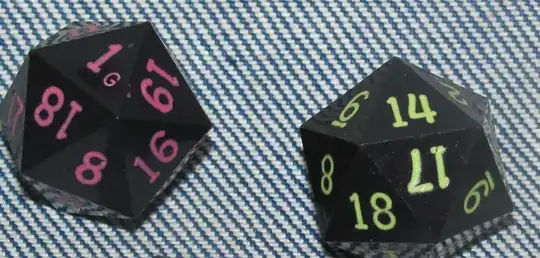

I picked up some Gamescience d20s based on this question. I got the black ones. They are very shiny!
Of course, they are unpainted. How can I paint/ink/color the numbers to get very high contrast between the numbers and the die?

I experimented with the methods proposed (except liquid white-out; couldn't find any), with the following results:
Paint: I used acrylic paint to fill in the numbers and paper towel to remove the excess. Very good opacity with this method, but I could not get enough paint to stay in the numbers during the removal of the excess. I tried various drying times before removing the excess, but could not get the results I wanted. Maybe another type of paint would work better?
Marker: I used Sharpie ultra-fine point white marker. My hands are not as steady as they used to be, so I had a hard time getting a neat and tidy finished appearance. The markings were not very opaque and did not provide great contrast. (I'm guessing that black marker on light colored dice would provide much better results.)
Crayon: I experimented with several brands and types of crayon. Crayola seems to work the best, probably because of the higher quality wax, which is softer and clings in the grooves of the numbers better. Specifically the Crayola GelFX crayons worked the best. They are made for writing on black paper, so the pigments are very opaque, and the wax is very soft and sticky; really stays in the numbers. Time will tell if it holds up to heavy use.
Below is an image of two of the dice filled with Crayola GelFX 'Spring Green' and 'Tickle Me Pink'. (The girls thought white was booooring).
alt text
Update
(2012-July-26)
It's coming up on 2 years now (21 months) since I used the crayon on these dice. They have had moderate to heavy use in that time. The color has shown no signs of wear or fading, and it is staying in the numbers right where I put it.
Conclusion: Crayola Gel FX crayons are the way to go. Color goes on easy, fills well, and is very opaque.

  • If you fill in the number with something like crayon, isn't that going to defeat the purpose of buying precision dice, since the weight will no longer be evenly distributed? – Eugene Katz Nov 22 '11 at 18:54
    @EugeneKatz The precision in the sharpness of the edges is more important for the design than the slight variation due to lost material. They're not originally specially weighted to compensate for the difference between the material removed for '1' versus for '20' anyway. (That would take a ridiculously expensive manufacturing process.) Note that casino dice have filled pips for this very reason—it restores the balance of the die. Crayon is thus likely better than pen for this. – SevenSidedDie Jul 26 '12 at 15:25
  • Gel FX crayons or markers? I can't find Gel FX crayons anywhere (online or in stores). – javafueled Aug 26 '13 at 16:27
  • @javafueled: Crayons. I suppose it's possible that they don't make them anymore. Basically, you want a nice soft crayon that is made for use on black paper. That way, the pigment is very opaque. – Stewbob Aug 26 '13 at 17:27
  • The following two products might be acceptable substitutes for Gel FX: http://www.crayola.com/products/dryerase-bright-crayons-product/, http://www.crayola.com/products/16-ct-metallic-fx-crayons-regular-size-product/, but I haven't tested either one. – Stewbob Aug 26 '13 at 17:31
  • I have the dry erase set. Very good results. Though I'm also interested in whether the Crayola Gel FX you have (if you still have them) are "water soluble." My research suggests that the Gel FX crayons are/were a Crayola mass-market choice where customers might also be looking at Faber Castell's Gelato series. Gelato's appear to be water soluble, which would not seem to be suited for gaming environments or your experience with "endurance." – javafueled Aug 26 '13 at 19:53
  • I don't still have the box the Crayolas came in. Though I can tell you that when an art supply like that says 'water soluble', they generally mean, "if you scrub really hard with soap and water, it might not stain your clothes". The Crayola Gel FX have proven impervious to incidental spills, and I remember that I had a deuce of a time getting it all off my fingers when I was first coloring the dice; though soap and water and scrubbing did work for clean-up, so they would still technically be described as water soluble. – Stewbob Aug 26 '13 at 20:56
