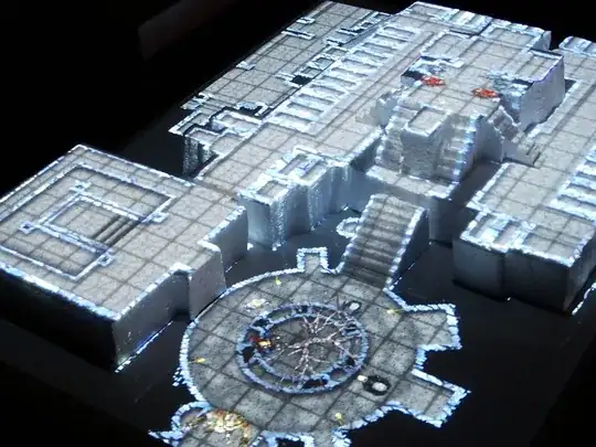

Projection Surface
You can use a white table, or a foam board, but I find if you can get a shiny surface, the projection will look more crisp. I use a dry-erase board and it looks great and has the added bonus that magnets stick to it, so I can use magnetic base figures, though, I typically use the index card trick (see below), as it is most convenient.
I have also used battle mats, including clear ones, but its generally easier and looks better to do the grid with the projection. I've even gone as far as using foam and a foam cutter for 3-dimensional projections.
