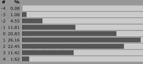

One close approximation that uses standard D&D dice and meets your criteria of only using a single mathematical operation is 4*(min(d4, 3)) - 8, or in anydice terms 4d{1,2,3,3} - 8 (or equivalently 4d{-1,0,1,1})
This is pretty fast and easy to explain, you just roll 4 d4s (treating any 4s as 3s instead) and add up the results, then subtract 8 to get to the desired range.
Treating 4s as 3s instead is what gives this distribution its asymmetry and bias towards higher modifiers (so is unfortunately unavoidable), but the math that needs to be done afterwards is just a single subtraction so it is one division simpler than using 4d6k3. I'd argue "treat 4s as 3s instead" is roughly as simple as "determine the highest 3 of these 4 dice" in terms of mental effort, so those steps offset and leave the overall effort of this method lower than 4d6k3.
In the linked AnyDice program, I also included the Fudge dice method proposed by @Dan B in as a comparison point which is 5d{-1,0,1}k4 or equivalently 5d3k4 - 8. They are very similar to each other (more similar in fact than they are to 4d6k3) so should be interchangable depending on which dice you have on hand. View the "Graph" tab to be able to compare the distributions most easily.

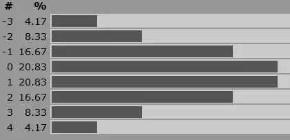

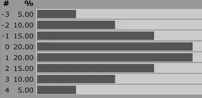

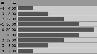

One easy way to get a bell curved distribution of [-4,4] is to take 1d5 - 1d5 (i.e. roll 1d6 rerolling 6s and then roll 1d6 again subtracting from the total):
However, this method loses the skew toward higher values and is less centrally biased. Let's fix these issues individually.
The Skew
If we want the results to be skewed towards the higher results, we simply want the positive die to have a greater mean than the lower die. This can be done in a number of ways, but I like reducing the negative die to 1d4.
This gives us 1d5 - 1d4:
While it isn't quite as skewed to the positive numbers as 4d6k3, it is better.
